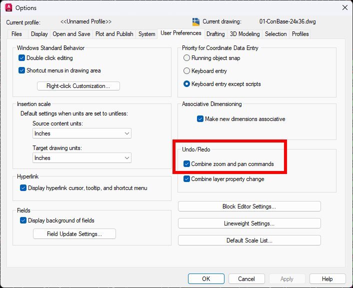

  7. As far as I know, you can't exclude them. I understand the annoyance though and people have been complaining about it for years, but it's just the way Autocad works. The best you can do is open your Options and make sure you have "Combine Zoom and Pan Commands" checked. This will combine consecutive zoom and pan operations into one Undo instead of several.
