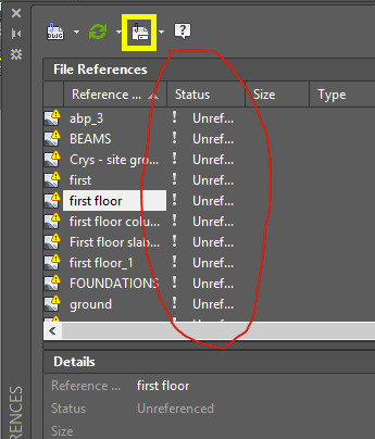

  1. like Steven said explode,overkill, purge this only removes it from model/paper space but then you have to detach the reference so its "removed" from the drawing. I think it would still show up in "External refrences" like this. Here is something Tharwat made.
