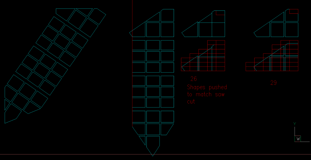

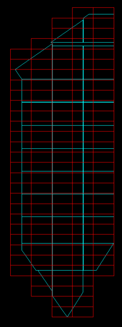

  1. Had another play, no code if you squash your shapes so gap is saw cut thickness you can save a lot of sheets. The cost of a drafts person v's sheets not sure in this case as so many needed. I also aligned a copy of a group of sheets. Then used rectangular array. For squashed answer maybe move sheets down a bit as top sheets are 8mm wide cut out. There is a new post that creates a boundary around objects so using that can work out a mega sheet that is an array of sheets as the sheet size to use in the nesting process. I have a make array around an object. I created the 2nd image using some smart move functions.
    1 point
