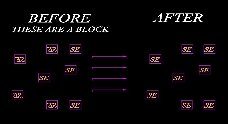

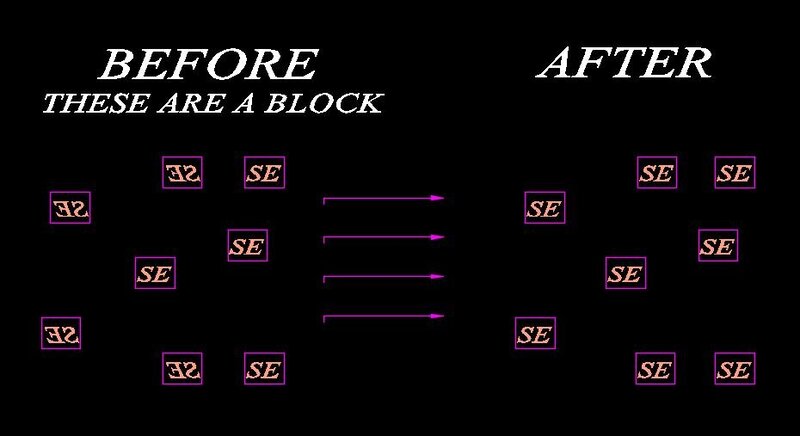

  5. In the mirror command the letter inside block get inverse . are there any lisp code mirroring block without reveres letter inside them. And how we can correct them after mirroring, as the following picture ::
