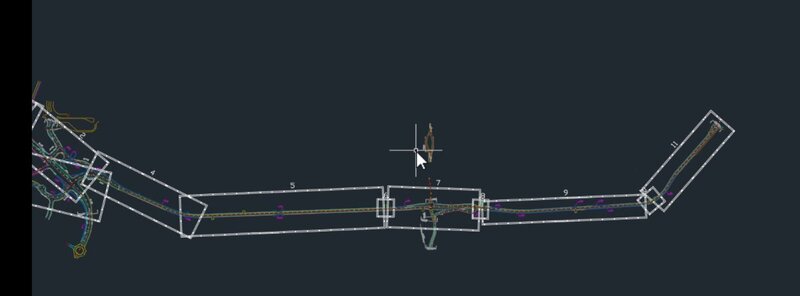

  3. You can see here the differences between the rectangles. Each rectangle is for different team of workers. I can't use regular sizes
