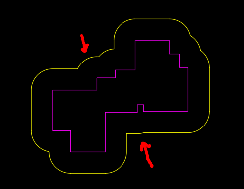

  1. That is a hard shape to change, explode, fillet and erase comes to mind as 1st answer. Ok 2nd answer select pline segments in sequence, no arcs, then make a new pline from new line segments. So try this. Just pick segments press enter to stop picking it will close automatically. You must pick in order. (defun getplineseg (elst / elst ename pt param preparam postparam) (setq ename (car elst)) (setq pt (cadr elst)) (setq pt (vlax-curve-getClosestPointTo ename pt)) (print (setq param (vlax-curve-getParamAtPoint ename pt)) ) (print (setq preparam (fix param)) ) (print (setq postparam (1+ preparam)) ) (setq pt1 (vlax-curve-getPointAtParam ename preparam) pt2 (vlax-curve-getPointAtParam ename postparam)) ) (defun c:wow ( / oldsnap ent mp1 mp2 pt1 pt2 mpst) (setq oldsnap (getvar 'osmode)) (setvar 'osmode 0) (setvar 'filletrad 0.0) (setq ent (entsel "\nSelect pline segment: ")) (getplineseg ent) (command "pline" pt1 pt2 "") (setq mp1 (mapcar '* (mapcar '+ pt1 pt2) '(0.5 0.5))) (setq mpst mp1) (while (setq ent (entsel "\nSelect pline segment: ")) (getplineseg ent) (command "pline" pt1 pt2 "") (setq mp2 (mapcar '* (mapcar '+ pt1 pt2) '(0.5 0.5))) (command "fillet" mp1 mp2) (setq mp1 mp2) ) (setq obj (vlax-ename->vla-object (entlast))) (vlax-put obj 'Closed -1) (princ) )

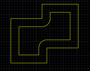

  5. Here's an approach that might have some potential although there are a few coding challenges. Using offset, create an offset shape 1.5 mm outside the original shape. Delete all the fillets and replace them with chamfers. Note that if a fillet arc is not between a vertical and horizontal line then both the arc and the line "inside" should be deleted. Chamfer the resulting lines. Now construct an offset curve of 1.5 inside this shape. Replace the arcs with fillets and you have the desired end product! The most challenging coding part of this approach is determining which line segments should be deleted after the initial offset shape (i.e., the inside lines).
    1 point

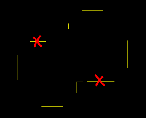

  6. Before writing a routine, you must check that the conditions are logically flawless. From the length between polyline nodes, we need to distinguish between lines to be taken and lines not to be taken. Once the loop is run once, these two white lines in the example must survive. Since the rule is not grid snap 1.5 because the result's nodes do not fall to 1.5, deleting the right line must be done by looping once more with the result of the first loop. The left white line will survive though. Since the general routine makes judgments by comparing the front and back points, a new routine may be needed to estimate the edges using extension lines at the nodes at both ends. Extract the coordinates of each point of the polyline, first extract the cases where both sides are 1.5 or more from the length of the line segment (points marked with a 1.5 radius circle), and then draw only one side. After marking the point (marked by x) that is greater than 1.5, then draw a line first when there are continuous circles, draw directly towards the next point x on the circle. Now, we need to find the included angle in all coordinates other than 0 90 180 270 and remove that node. You also need to decide which side of the line to align it with. This is the guessing based on only the nodes, but if there is a condition that the area should not be modified in a way that makes it smaller, your example can be valid. In this case, you must add a routine to determine the area of the closed area and a routine to determine whether a point is inside or outside the closed polyline. It will become more complicated than guessing based on just the nodes.
