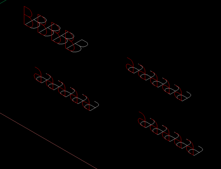

  4. Ok understand what you want and a simple answer is to duplicate the text onto a different layer and rotate3d that text. Then you can turn off plan view text and see Front text. Having worked with 3d points re CIV3D you will still have a mess when it comes to reading the points and text form a front view. Anyway try this on a few points. (defun c:wow ( / ss ent obj ) (command "layer" "M" "TEXTfront" "") (prompt "Select Text") (setq ss (ssget '((0 . "TEXT")))) (repeat (setq x (sslength ss)) (setq ent (ssname ss (setq x (1- x)))) (setq obj (vlax-ename->vla-object ent)) (setq inspt (vlax-get obj 'insertionpoint)) (command "copy" ent "" "0,0,0" "0,0,0") (setq obj (vlax-ename->vla-object (entlast))) (vlax-put obj 'layer "TEXTfront") (vlax-put obj 'normal '(0 -1 0)) (vlax-put obj 'insertionpoint inspt) ) (princ) )
    1 point
