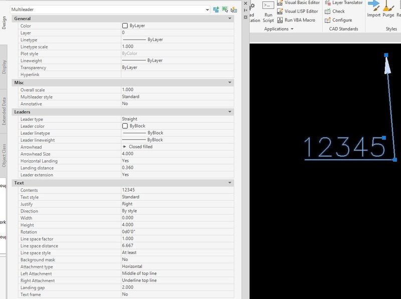

  4. Yes, thanks @hosneyalaa TextJustify was the one. (vl-load-com) ;; ---------------------=={ MLEADER_Recreate }==-------------------------- ;; ----------------------------------------------------------------------- ;; AUTHOR & ADDITIONAL CODE ;; Author: by 3dwannab, Copyright © 2023 ;; ABOUT / NOTES ;; - Recreates MULTILEADER/s with 2 or 3 points ;; - This solves the issues with MLEADER styles been overridden in the properties dialog ;; FUNCTION SYNTAX ;; Short-cut MR ;; Long-cut MLEADER_Recreate ;; VERSION DATE INFO ;; Version 1.0 2018.08.26 1st draft 2018.07.26 ;; Version 1.1 2019.03.18 Added ScaleFactor & TextFrameDisplay to newly created MLs' ;; Version 1.2 2023.08.02 Added TextBackGroundFill to newly created MLs' if it exists on old MLs ;; Version 1.3 2023.08.24 Added TextJustify to newly created MLs' ;; TO DO LIST ;; - To update with mleader_vlML.lsp in my Help folder ;; ----------------------------------------------------------------------- ;; ------------------=={ MLEADER_Recreate START }==----------------------- (setq *MLEADER_Recreate-Ver* "1.2") (defun c:MLEADER_Recreate nil (c:MR)) (defun c:MR (/ acDoc *error* cnt en endata getLay getTxtJustify getTxtBkgFill getLeaderCnt getStyle getTxtRot getTxtStr getTxtWidth getScaleFactor getTextFrameDisplay ldxf10_1 ldxf10_2 ldxf10_3 lstpts lstptslen obj objnew sel var_cmdecho var_osmode) (defun *error* (errmsg) (and acDoc (vla-EndUndoMark acDoc)) (and errmsg (not (wcmatch (strcase errmsg) "*CANCEL*,*EXIT*")) (princ (strcat "\n<< Error: " errmsg " >>\n")) ) (setvar 'cmdecho var_cmdecho) (setvar 'osmode var_osmode) ) (setq acDoc (vla-get-ActiveDocument (vlax-get-acad-object))) (or (vla-EndUndoMark acDoc) (vla-StartUndoMark acDoc)) (setq var_cmdecho (getvar "cmdecho")) (setq var_osmode (getvar "osmode")) (setvar 'cmdecho 0) (setvar 'osmode 0) (setq ss1 (ssget '((0 . "MULTILEADER")))) (setq sel (ssadd)) (setq sel_mls_not_compat (ssadd)) (setq cnt 0) (repeat (setq cnt (sslength ss1)) (setq cnt (1- cnt)) (setq en (_dxf -1 (entget (ssname ss1 cnt))) endata (entget en) obj (vlax-ename->vla-object en) getLay (vla-get-Layer obj) getScaleFactor (vla-get-ScaleFactor obj) getStyle (vla-get-StyleName obj) getTextFrameDisplay (vla-get-TextFrameDisplay obj) getTxtBkgFill (vla-get-TextBackGroundFill obj) getTxtJustify (vla-get-TextJustify obj) getTxtRot (vla-get-TextRotation obj) getTxtStr (vla-get-TextString obj) getTxtWidth (vla-get-TextWidth obj) lstpts (vl-remove-if-not '(lambda (p) (eq (car p) 10)) (reverse endata) ) lstptslen (length lstpts) ldxf10_1 (cdr (nth 1 (reverse lstpts))) ldxf10_2 (cdr (nth 3 (reverse lstpts))) ldxf10_3 (cdr (nth 2 (reverse lstpts))) getLeaderCnt (vla-get-LeaderCount obj) ) ;; setq (cond ((or (> lstptslen 5) (< lstptslen 4)) (ssadd en sel_mls_not_compat) ) ((or (= lstptslen 5) (= lstptslen 4)) (progn (if (= lstptslen 5) (command "_.MLEADER" "_H" "_L" "_O" "_M" 3 "_X" "_non" (trans ldxf10_1 0 1) "_non" (trans ldxf10_2 0 1) "_non" (trans ldxf10_3 0 1) "" ) ) (if (= lstptslen 4) (command "_.MLEADER" "_H" "_L" "_O" "_M" 2 "_X" "_non" (trans ldxf10_1 0 1) "_non" (trans ldxf10_3 0 1) "" ) ) (setq entnew (entlast) objnew (vlax-ename->vla-object entnew) ) (if en (progn (if (/= getTxtWidth 0) (vla-put-TextWidth objnew (/ getTxtWidth getScaleFactor)) ;; Testing the dividing the text width by the scale factor of the old mleader. ) (vla-put-TextBackGroundFill objnew getTxtBkgFill) (vla-put-TextJustify objnew getTxtJustify) (vla-put-Layer objnew getLay) (vla-put-ScaleFactor objnew getScaleFactor) (vla-put-StyleName objnew getStyle) (vla-put-TextFrameDisplay objnew getTextFrameDisplay) (vla-put-TextRotation objnew getTxtRot) (vla-put-TextString objnew getTxtStr) (entdel en) (ssadd entnew sel) ) ) ) ) ) ) ;; repeat (if (> (sslength sel) 0) (progn (princ (strcat "\n: ------------------------------\n\t\t<<< You've created " (itoa (sslength sel)) (if (> (sslength sel) 1) " new MULTILEADERS" " new MULTILEADER") ". A legend has been born >>>\n: ------------------------------\n" ) ) (sssetfirst nil sel) ) ) (if (and sel (> (sslength sel_mls_not_compat) 0)) (progn (princ (strcat "\n: ------------------------------\n\t\t*** Program found " (itoa (sslength sel_mls_not_compat)) (if (> (sslength sel_mls_not_compat) 1) " MULTILEADERS that are" " MLEADER that is" ) " not compatible ***\n: ------------------------------\n" ) ) (princ (strcat "\n: ------------------------------\n\t\t*** NOTE: " (itoa (sslength sel)) (if (> (sslength sel) 1) " successfully converted MULTILEADERS have been" " successfully converted MULTILEADER has been" ) " selected ***\n: ------------------------------\n" ) ) ) ) (*error* nil) (princ) ) ;; end MR defun ;; ----------------------------------------------------------------------- ;; ----------------------=={ Functions START }==-------------------------- ;;----------------------------------------------------------------------;; ;; _dxf ;; Finds the association pair, strips 1st element ;; args - dxfcode elist ;; Example - (_dxf -1 (entget (ssname (ssget) 0))) ;; Returns - <Entity name: xxxxxxxxxxx> (defun _dxf (code elist) (cdr (assoc code elist)) ) ;; ----------------------------------------------------------------------- ;; ---------------------=={ Functions END }==-- -------------------------- (princ (strcat "\n: ------------------------------\n\"3dwannab_MLEADER_Recreate.lsp\" loaded | Version " *MLEADER_Recreate-Ver* " by 3dwannab. Type \"MLEADER_Recreate\" OR \"MR\" to run.\n: ------------------------------\n" ) ) (princ) ;; ----------------------------------------------------------------------- ;; -------------------=={ MLEADER_Recreate END }==------------------------ ; (c:MR) ;; Uncommet for testing

  5. @3dwannab What want to change https://help.autodesk.com/view/OARX/2022/ENU/?guid=GUID-95FD33C2-DF78-4014-933C-9AC124E6A35D

  7. IDK what kinda of mleader your using but this is what dumps when selecting one. (RO) = Read Only and can only use vla-get ; IAcadMLeader 3d8a0ae0 : TeighaX Multi-Leader Interface ; Property values : ; Application (RO) = #<VLA-OBJECT IAcadApplication 000000002670DAF0> ; ArrowheadBlock = "" ; ArrowheadSize = 0.18 ; ArrowheadType = 0 ; BlockConnectionType = 0 ; BlockScale = 1.0 ; color = 256 ; ContentBlockName = "" ; ContentBlockType = 6 ; ContentType = 2 ; Database (RO) = #<VLA-OBJECT IAcadDatabase 000000003DF087E8> ; Document (RO) = #<VLA-OBJECT IAcadDocument 000000003D8D33E8> ; DogLegged = -1 ; DoglegLength = 0.36 ; EntityName (RO) = "AcDbMLeader" ; EntityType (RO) = NIL ; Handle (RO) = "81" ; HasExtensionDictionary (RO) = -1 ; Hyperlinks (RO) = #<VLA-OBJECT IAcadHyperlinks 000000003DF7D9A8> ; LandingGap = 0.09 ; Layer = "0" ; LeaderCount (RO) = 1 ; LeaderLineColor = #<VLA-OBJECT IAcadAcCmColor 000000000299F328> ; LeaderLineType = "" ; LeaderLineWeight = -2 ; LeaderType = 1 ; Linetype = "ByLayer" ; LinetypeScale = 1.0 ; Lineweight = -1 ; Material = "ByLayer" ; ObjectID (RO) = 44195888 ; ObjectID32 (RO) = 44195888 ; ObjectName (RO) = "AcDbMLeader" ; OwnerID (RO) = 1034257008 ; OwnerID32 (RO) = 1034257008 ; PlotStyleName = "ByLayer" ; ScaleFactor = 1.0 ; StyleName = "Standard" ; TextAttachmentDirection = 0 ; TextBackgroundFill = 0 ; TextBottomAttachmentType = 0 ; TextDirection = 1 ; TextFrameDisplay = 0 ; TextHeight = 0.18 ; TextJustify = 1 ; TextLeftAttachmentType = 1 ; TextLineSpacingDistance = NIL ; TextLineSpacingFactor = 1.0 ; TextLineSpacingStyle = 1 ; TextRightAttachmentType = 3 ; TextRotation = 0.0 ; TextString = "" ; TextStyleName = "Standard" ; TextTopAttachmentType = 0 ; TextWidth = 0.0 ; TrueColor = #<VLA-OBJECT IAcadAcCmColor 000000000299FF28> ; Visible = -1 ; ; Methods supported : ; AddLeader () ; AddLeaderLine (2) ; AddLeaderLineEx (1) ; ArrayPolar (3) ; ArrayRectangular (6) ; Copy () ; Delete () ; Erase () ; GetBlockAttributeValue (1) ; GetBlockAttributeValue32 (1) ; GetBoundingBox (2) ; GetDoglegDirection (1) ; GetExtensionDictionary () ; GetLeaderIndex (1) ; GetLeaderLineIndexes (1) ; GetLeaderLineVertices (1) ; GetVertexCount (1) ; GetXData (3) ; Highlight (1) ; IntersectWith (2) ; Mirror (2) ; Mirror3D (3) ; Move (2) ; RemoveLeader (1) ; RemoveLeaderLine (1) ; Rotate (2) ; Rotate3D (3) ; ScaleEntity (2) ; SetBlockAttributeValue (2) ; SetBlockAttributeValue32 (2) ; SetDoglegDirection (2) ; SetLeaderLineVertices (2) ; SetXData (2) ; TransformBy (1) ; Update ()

  8. Isn't it rather the TextJustify property you want to get instead of TextAlignmentType?
