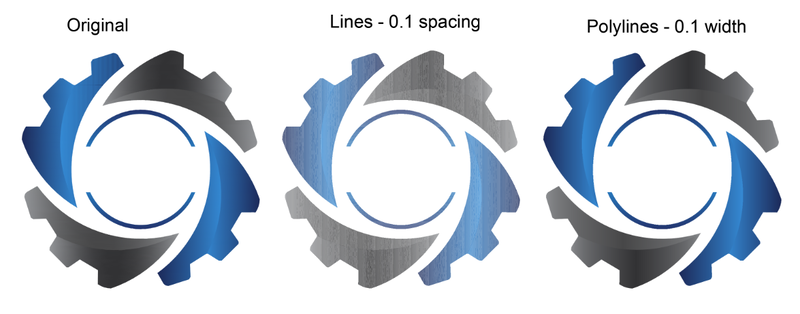

  2. Hi SLW This one works OK with LINEAR gradients, but for some reason, it doesn't match exactly the Cylindrical ones. I tried various interpolation methods, but none seems accurate. ;Replace gradient Hatch with lines ;Stefan M - 12.08.2023 (defun c:gradline ( / *error* o ss i e a col1 col2 en l c x1 x2 c1 c2 rgb r m ) ;;; (setq *error* (err)) (setq o (vlax-3d-point 0.0 0.0 0.0)) (or *spacing* (setq *spacing* 0.1)) (or *del* (setq *del* "No")) (if (and (setq ss (ssget "_:L" '((0 . "HATCH") (450 . 1) (470 . "LINEAR,CYLINDER,INVCYLINDER")))) (progn (initget 6) (setq *spacing* (cond ((getdist (strcat "\nSpecify line spacing <" (rtos *spacing*) ">: "))) (*spacing*) ) ) ) (progn (initget "Yes No") (setq *del* (cond ((getkword (strcat "\nDelete original hatch [Yes/No] <" *del* ">: "))) (*del*) ) ) ) ) (repeat (setq i (sslength ss)) (setq e (vlax-ename->vla-object (ssname ss (setq i (1- i)))) a (vla-get-gradientangle e) col1 (vla-get-gradientcolor1 e) col2 (vla-get-gradientcolor2 e) ) (setq en (entlast) l nil) (setq c (vla-copy e)) (vla-rotate c o (- a)) (vla-getboundingbox c 'x1 'x2) (setq x1 (car (vlax-safearray->list x1)) x2 (car (vlax-safearray->list x2)) ) (if (> (- x2 x1) *spacing*) (progn (vla-put-HatchObjectType c acHatchObject) (vla-setpattern c acHatchPatternTypeUserDefined "_USER") (vla-put-patternangle c (/ pi 2)) (vla-put-patternscale c *spacing*) (setq c1 (mapcar '(lambda (p) (vlax-get col1 p)) '(red green blue)) c2 (mapcar '(lambda (p) (vlax-get col2 p)) '(red green blue)) ) (if (eq (vla-get-gradientname e) "INVCYLINDER") (mapcar 'set '(c1 c2) (list c2 c1)) ) (vla-put-truecolor c col1) (command "_explode" (vlax-vla-object->ename c)) (while (setq en (entnext en)) (setq l (cons (list (car (vlax-curve-getstartpoint en)) (vlax-ename->vla-object en) ) l ) ) ) (foreach x l (if (eq (vla-get-gradientname e) "LINEAR") (setq rgb (mapcar '(lambda (c1 c2) (fix (+ 0.5 c1 (/ (* (- c2 c1) (- (car x) x1)) (- x2 x1)))) ) c1 c2 ) ) (progn (setq r (/ (- x2 x1) 2.0) m (/ (+ x2 x1) 2.0) rgb (mapcar '(lambda (c1 c2 / q u) (setq q (abs (- m (car x))) u (atan (/ (sqrt (- (* r r) (* q q))) q)) ) (fix (+ 0.5 c1 (/ (* (- c2 c1) 2 u) pi))) ) c1 c2 ) ) ) ) (vla-setrgb col1 (car rgb) (cadr rgb) (caddr rgb)) (vla-put-truecolor (cadr x) col1) (vla-rotate (cadr x) o a) ) (if (eq *del* "Yes") (vla-delete e)) ) ) ) ) ;;; (*error* nil) (princ) )
