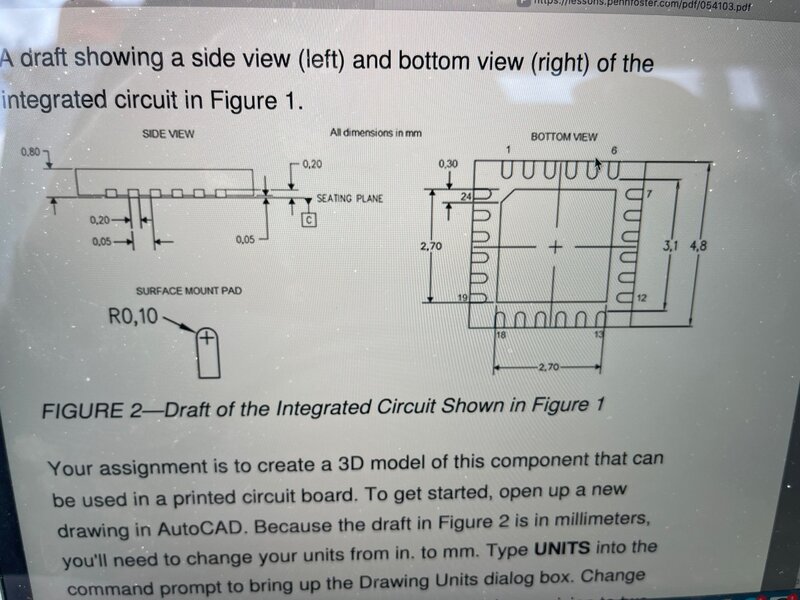

  1. I am at a loss for drawing the integrated circuit model
    1 point
