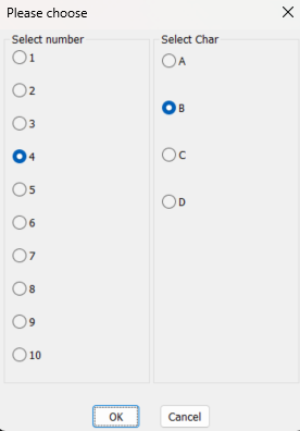

  3. Like Mhupp why are you trying to jam everything into 1 dcl ? Autocad made toolbars for this idea you can have each of the dcl "radio button column" as a toolbar. No Cond required as the pick an icon there is a matching do something. Anyway here is an example of using radio buttons which are named RB1 RB2 etc auto created I have a 3 column as well need to test it again.Its a global program use in any code Multi radio buttons 2col.lsp Look at example code in Multi radio buttons 2 col. It returns the item number in the description list. AH:2col & AH:2col2 This is a tool bar I just made for some one. Put horizontal or vertical on edge of screen left and right. "steal.lsp" Look at image above post 2 and how many options are in the menu, the > means another menu, can have sub sub menu's.

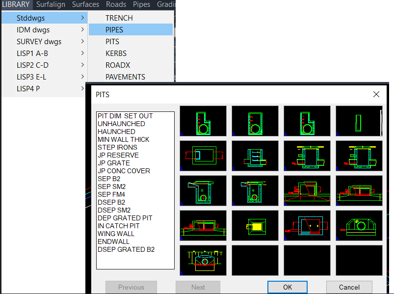

  6. Have you thought about using a pop menu much easier to write a mnu file than a dcl. can have more items than fit in default display as it has a Next button. Or even go down the toolbar.mnu option, again make your own using notepad. This is just to show how it would look. yeah I know pipes selected but pits shown 2 images joined.
