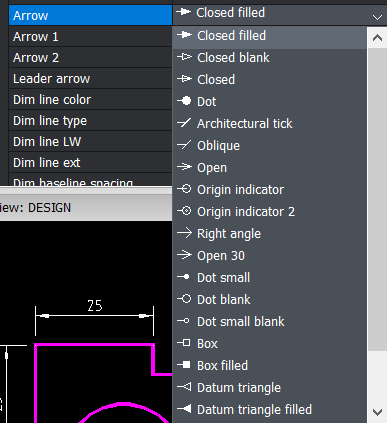

  5. This may be helpful. Trying to remember I think it was by number rather than Description. Some are not obvious (getvar 'dimblk) "Architectural tick" is "ArchTick" "Box" is "BoxBlank" "Dot" is "Dot" To find others change dimstyle arrows and (getvar 'dimblk)
