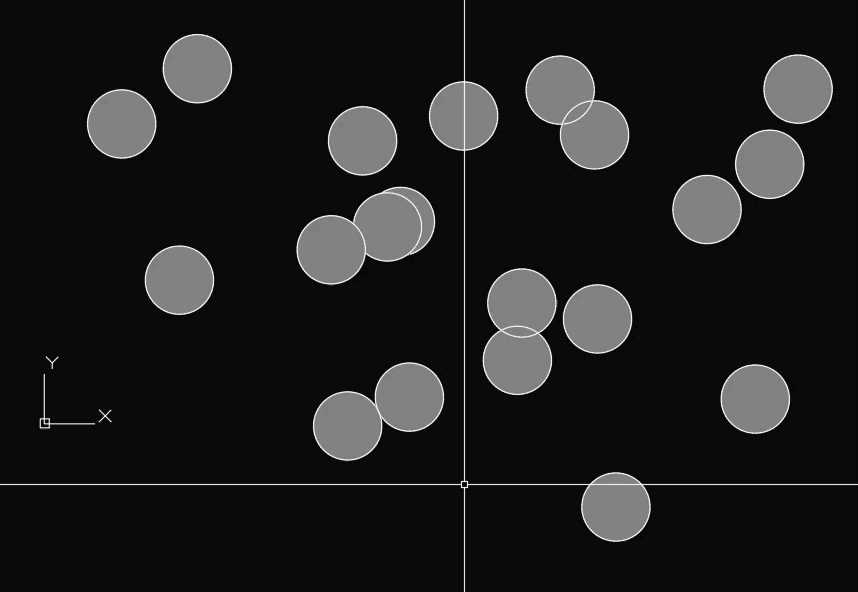

  1. Was your friend ChatGPT ? "vlax-curve-curve-intersect" is not a native function. This should do what you want: (defun c:foo (/ s s2) ;; RJP » 2023-06-13 (cond ((setq s (ssget '((0 . "HATCH") (410 . "Model")))) (setq s2 (ssget "_X" '((0 . "HATCH") (410 . "Model")))) (foreach e (mapcar 'cadr (ssnamex s2)) (or (ssmemb e s) (entdel e))) ) ) (princ) )
