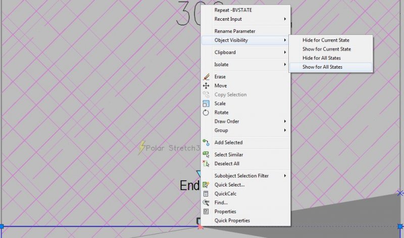

  5. Just come across this old post, it is possible if you pick Alignment property insertion and right-click on it or in the other words, hit the alignment property definition line to all grips appear and roll over it (don't select)just right click on the middle square.
