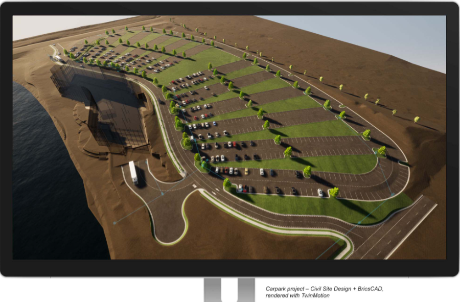

  3. It has a long history here in Australia started as Civilcad. like 40 years ago. I am a ex State manager for Civilcad so I am biased towards it. I am retired but where used to work we used it every day with multiple designers. https://civilsitedesign.com.au/ Over at Bricscad world there is a fantastic demonstration of how to do a main road, connecting car park, kerb returns and so much more. Will try to find.
