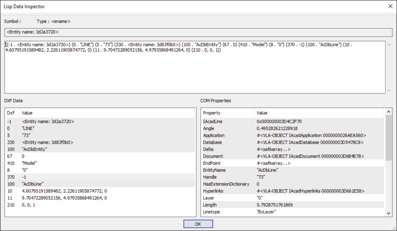

  5. @mhupp please clear me , Where it come from? LISP DATA INSPECTOR
    1 point
  6. (setq LW (ssget "_X" '((370 . *)))) -Edit That wouldn't work because bylayer is shown as -1 byblock as -2 but doesn't show up with entget. Using Relational Operators with ssget (setq LW (ssget "_X" '((-4 . ">") (370 . 0))))
    1 point
