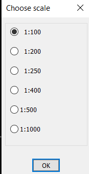

  1. You need to add a backslash before each double quote when you include a string into another. '("kzzbss :dialog{" "label=\"temporary dialog\";" ":popup_list{key=\"tag\";label=\"Attributes:\";list=\"List1\\nList2\\nList3\\nList4\\nList5\\nList6\\nList7\\nList8\";}" ":edit_box{key=\"str\"; label=\"value:\";}" "ok_cancel;}")

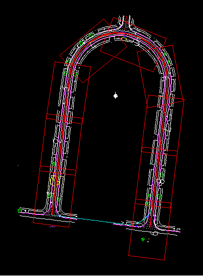

  3. I do something similar I would suggest make the rectang a block you need 2 land and portrait, so the block can have a scale that eventually reflects the mview scale. When placed over dwg objects. Has advantage of angle also.
