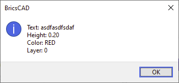

  1. Ok my take on question 1 redid code to cater for text color is by layer. There is no 62 dxf for bylayer. (defun c:textprop( / textobj textinfo textvalue textcolor textlayer) (setq textobj (ssname (ssget "_+.:E:S" (list (cons 0 "TEXT,MTEXT"))) 0)) (if (= textobj nil) (alert "A text type object was not picked ") (progn (setq textinfo (entget textobj)) (setq textvalue (cdr (assoc 1 textinfo))) (setq textheight (cdr (assoc 40 textinfo))) (setq textlayer (cdr (assoc 8 textinfo))) (if (= (setq textcolor (cdr (assoc 62 textinfo))) nil) (alert (strcat "Text contents: " textvalue "\nHeight: " (rtos textheight 2 1) "\nColor: " "Bylayer" "\nLayer: " textlayer)) (alert (strcat "Text contents: " textvalue "\nHeight: " (rtos textheight 2 1) "\nColor: " (rtos textcolor 2 0) "\nLayer: " textlayer)) ) ) ) (princ) ) (c:textprop) Re do a color need a cond. So replace the 2nd Alert with a cond, have a go. Inside a progn so 2nd alert still works inside that progn. Noticed the 1st attempt did not have the cdr's. If your happy can use "*TEXT" but it will find Dtext and Rtext. But we never used them so maybe ok. I have a get properties lisp, just pick an object and you determine what you want returned so for say a circle would be centre point and radius, like you for a text return what is needed, there is another lisp out there that returns more items than I have done. Pline line arc props.lsp

  7. Ok this is version 1 for plines with straights only. Ver 2 would add circles, ver 3 would add ellipses and ver 4 would add plines with arcs. (defun c:wow ( / plent co-ord ss tot txt) (setq plent (entsel "\nPick pline ")) (setq co-ord (mapcar 'cdr (vl-remove-if-not '(lambda (x) (= (car x) 10)) (entget (car plent))))) (setq co-ord (cons (last co-ord) co-ord)) (setq ss (ssget "WP" co-ord '(( 0 . "*TEXT")))) (setq tot 0.0) (if (= ss nil) (alert "No text selected will now exit ") (repeat (setq x (sslength ss)) (setq txt (cdr (assoc 1 (entget (ssname ss (setq x (1- x))))))) (setq tot (+ (atof txt) tot)) ) ) (alert (strcat "Total is " (rtos tot 2 2 ) " for " (rtos (sslength ss) 2 0) " Items")) (princ) ) (c:wow) I think this is being missed will fix next version.

  8. Coming along way @AeJay for only 22 posts. to simplify things (setq textobj (ssname (ssget "_+.:E:S" (list (cons 0 "TEXT,MTEXT"))) 0)) (if (= textobj nil) >> (if (setq textobj (ssname (ssget "_+.:E:S" (list (cons 0 "TEXT,MTEXT"))) 0)) or (if textobj with two or more string side by side you can just join them into one ...(rtos textheight 2 1) "\nColor: " "Bylayer" "\nLayer: " textlayer)) ...(rtos textheight 2 1) "\nColor: Bylayer \nLayer: " textlayer)) I think your code would error or not display if selecting text that its color isn't 1-7 again from above join strings into one. ((= nColor 1)(strcat "\nColor: " "RED")) can just be ((= nColor 1) "\nColor: RED") My code keeps everything in a list. so their is only the selection set and the data variable. Entget ((-1 . <Entity name: 3eed7ec0>) (0 . "TEXT") (5 . "71") (330 . <Entity name: 3e488ae0>) (100 . "AcDbEntity") (67 . 0) (410 . "Model") (8 . "0") (62 . 1) (370 . -1) (100 . "AcDbText") (10 5.59944594793636 4.30743710947954 0.0) (40 . 0.2) (1 . "asdfasdfsdaf") (50 . 0.0) (41 . 1.0) (51 . 0.0) (7 . "Standard") (71 . 0) (72 . 0) (11 0.0 0.0 0.0) (210 0.0 0.0 1.0) (100 . "AcDbText") (73 . 0)) Becomes (8 . "0") (62 . 1) (40 . 0.2) (1 . "asdfasdfsdaf") Then values are put into list data '("0" 1 0.2 "asdfasdfsdaf") '(Layer color height textstring) finally (defun c:ttp (/ ss data) (while (setq ss (ssget "_+.:E:S" '((0 . "TEXT,MTEXT")))) ;while to allow you to keep selecting in the same command. (setq data (mapcar 'cdr (vl-remove-if-not '(lambda (x) (or (= (car x) 1) (= (car x) 40) (= (car x) 62) (= (car x) 8))) (entget (ssname ss 0))))) (if (= (length data) 3) (alert (strcat "Text: " (last data) "\nHeight: " (rtos (cadr data) 2 2) "\nColor: ByLayer \nLayer: " (car data))) (alert (strcat "Text: " (last data) "\nHeight: " (rtos (caddr data) 2 2) (cond ((= (cadr data) 1) "\nColor: RED") ((= (cadr data) 2) "\nColor: YELLOW") ((= (cadr data) 3) "\nColor: GREEN") ((= (cadr data) 4) "\nColor: CYAN") ((= (cadr data) 5) "\nColor: BLUE") ((= (cadr data) 6) "\nColor: MAGENTA") ((= (cadr data) 7) "\nColor: WHITE") (t (strcat "\nColor: " (itoa (cadr data)))) ;their are over 256 colors so if it isn't the first 7 display number ) "\nLayer: " (car data))) ) ) (princ) )

  9. Regarding int to color. I am again having the stringp nil error with this code I tried: (defun c:textprop( / textobj textinfo textvalue textcolor textlayer nColor) (setq textobj (ssname (ssget "_+.:E:S" (list (cons 0 "TEXT,MTEXT"))) 0)) (if (= textobj nil) (alert "A text type object was not picked ") (progn (setq textinfo (entget textobj)) (setq textvalue (cdr (assoc 1 textinfo))) (setq textheight (cdr (assoc 40 textinfo))) (setq textlayer (cdr (assoc 8 textinfo))) (if (= (setq textcolor (cdr (assoc 62 textinfo))) nil) (alert (strcat "Text contents: " textvalue "\nHeight: " (rtos textheight 2 1) "\nColor: " "Bylayer" "\nLayer: " textlayer)) (alert (strcat "Text contents: " textvalue "\nHeight: " (rtos textheight 2 1) (setq nColor(itoa textcolor)) (cond ((= nColor 1)(strcat "\nColor: " "RED")) ((= nColor 2)(strcat "\nColor: " "YELLOW")) ((= nColor 3)(strcat "\nColor: " "GREEN")) ((= nColor 4)(strcat "\nColor: " "CYAN")) ((= nColor 5)(strcat "\nColor: " "BLUE")) ((= nColor 6)(strcat "\nColor: " "MAGENTA")) ((= nColor 7)(strcat "\nColor: " "WHITE")) ) "\nLayer: " textlayer)) ) ) ) (princ) ) I also tried with same error of stringp nil: (defun c:textpropz( / textobj textinfo textvalue textcolor textlayer nColor) (setq textobj (ssname (ssget "_+.:E:S" (list (cons 0 "TEXT,MTEXT"))) 0)) (if (= textobj nil) (alert "A text type object was not picked ") (progn (setq textinfo (entget textobj)) (setq textvalue (cdr (assoc 1 textinfo))) (setq textheight (cdr (assoc 40 textinfo))) (setq textlayer (cdr (assoc 8 textinfo))) (if (= (setq textcolor (cdr (assoc 62 textinfo))) nil) (alert (strcat "Text contents: " textvalue "\nHeight: " (rtos textheight 2 1) "\nColor: " "Bylayer" "\nLayer: " textlayer)) (alert (strcat "Text contents: " textvalue "\nHeight: " (rtos textheight 2 1) (setq nColor(itoa textcolor)) (cond ((equal nColor 1)("\nColor: " "RED")) ((equal nColor 2)("\nColor: " "YELLOW")) ((equal nColor 3)("\nColor: " "GREEN")) ((equal nColor 4)("\nColor: " "CYAN")) ((equal nColor 5)("\nColor: " "BLUE")) ((equal nColor 6)("\nColor: " "MAGENTA")) ((equal nColor 7)("\nColor: " "WHITE")) ) "\nLayer: " textlayer)) ) ) ) (princ) )
