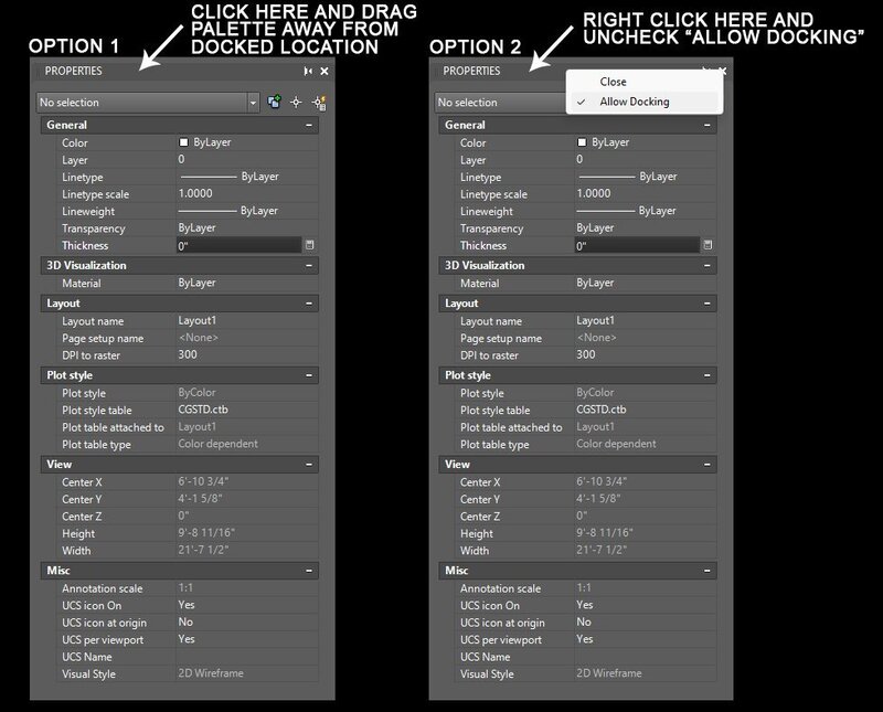

  3. Your Properties palette must be docked. In order to undock the palette, you have two options. Either click and drag the palette away from its docked location or right click at the top of the palette and uncheck "Allow Docking". Once the palette is undocked you can right click on the bar and uncheck "Auto Hide".
    1 point
