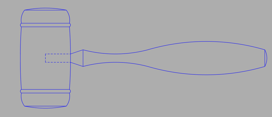

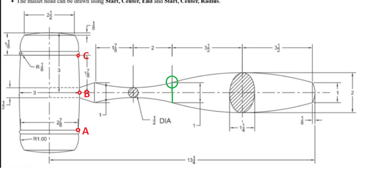

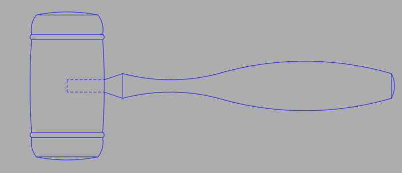

  10. However, using the supposition that the end of the band is in line with the mallet head, one can take an arc of radius 1/8", such that the perpendicular bisector of the arc to the chord (saggita) is 1/16". This gives a chord length (height of the band) of 55/256" which is tricky to dimension when seemingly the accuracy is 1/8". Picture doesn't look too bad.
    1 point
  11. That is certainly a solution, but would make the side to side dimension of the band 3' 0 1/8" which is wider than the mallet head. Perhaps that is what is wanted, but one could say that this is not a first class example of a drawing exercise.
    1 point
  12. The spacing of the two horizontal band is the diameter of the arc = 1/4".
    1 point
  13. Still you lack a height of the two horizontal bands. Perhaps this is partly an exercise in initiative! Draw the bands to any dimension that looks good.
    1 point
  14. After creating the straight construction lines as suggested by @ReMark, you can create several of the arcs by specifying the start point, a point along the arc, and an end point. Be sure to specify these points in a counter clockwise direction. For example, use points A, B and C as shown below. Note, there is a minor error in the drawing. The two arcs that meet at the green circle are not tangent and therefore there should be a vertical line (green) on the handle as noted.
    1 point
  15. I would start by drawing all the straight lines starting from the top (or bottom), and side to side, including the centerlines since, per the included image, as you are provided distances between lines and in a couple of cases the length of the line(s).
    1 point
  16. The instructions give you most of what you need to know. The ARC command can be used several ways--the method you use depends on the information you have available and where the arc has to go. It may help to draw some construction lines. There's a dashdot line through the center of the mallet, for instance, that you can offset (use the OFFSET command) to get the outer limit of the long arc in the center. By drawing a centerline through the handle, you can create an intersection at the center of each arc and use those to locate the center points. (Hint: use the SNAP filters.) As always, there are multiple strategies for any task in AutoCAD. Find the one that you're most comfortable with.
