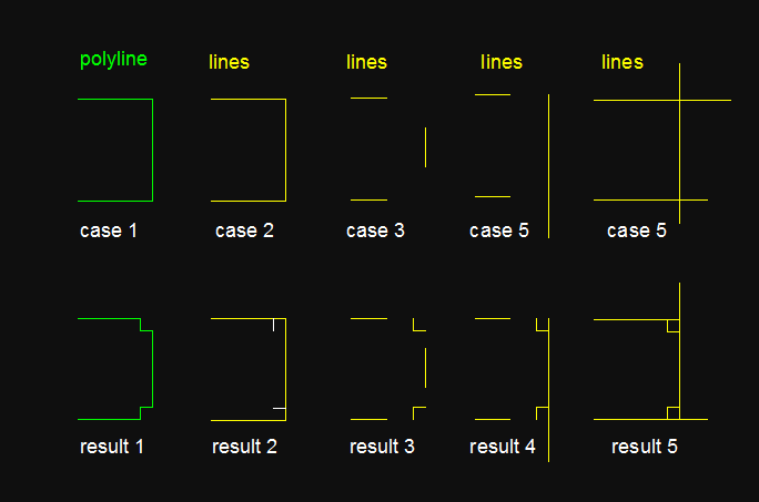

  11. Just my 0.02¢ for Case 3 though 5. Use a fillet of 0 to close the gaps. Then process the lines after to apply the square chamfer.
    1 point
