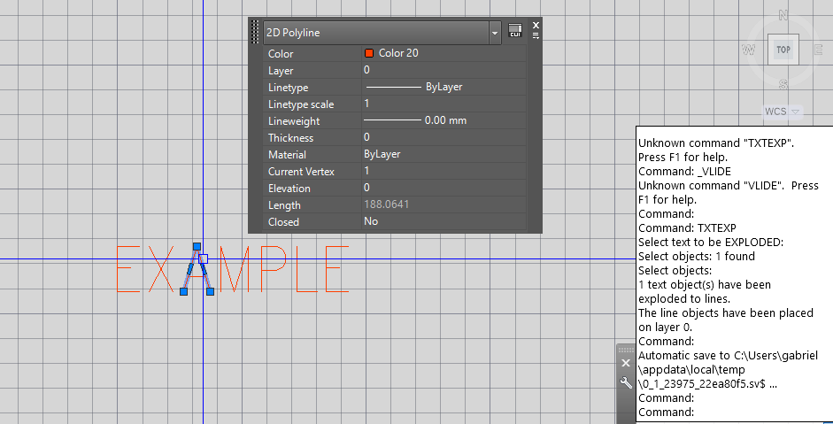

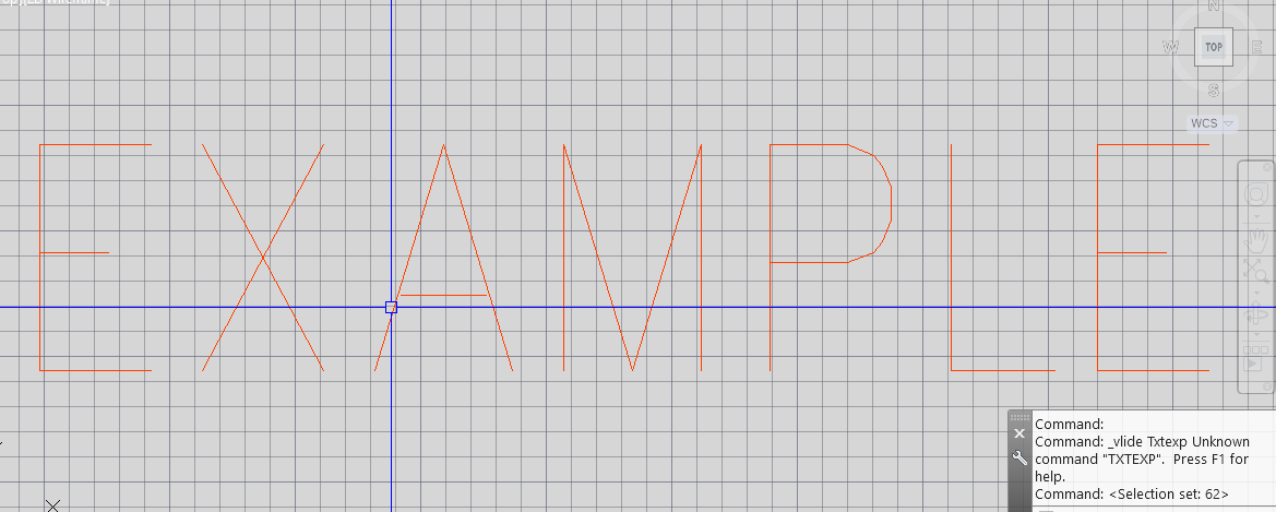

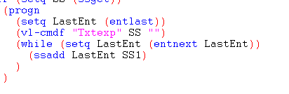

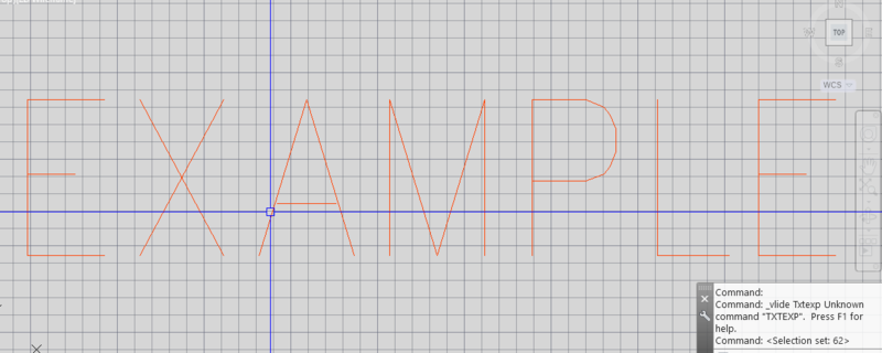

  1. I do not why , fom lisp I get this But from command line TXTEXP. work as expected neither with
    1 point
  2. Thank you Mhupp, works perfect now. Cheers
