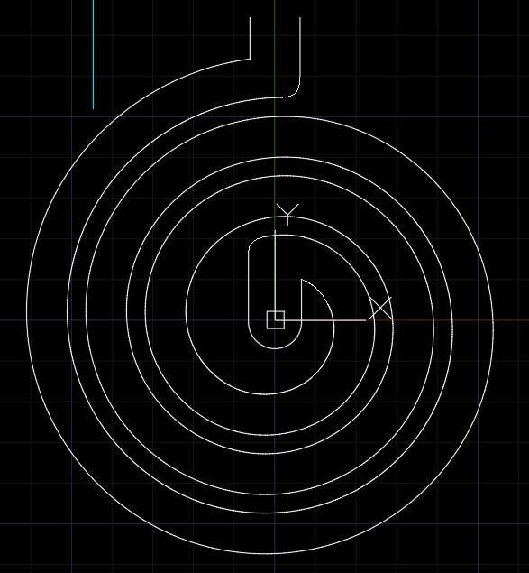

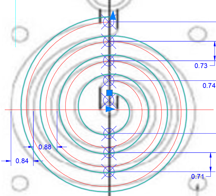

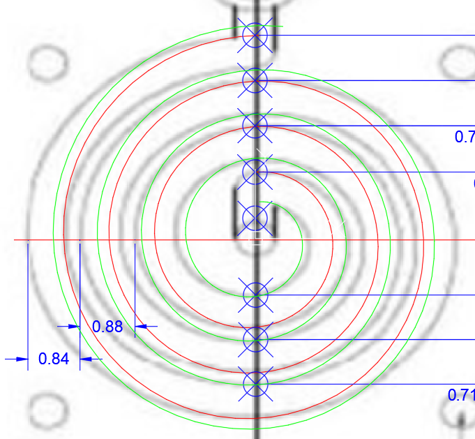

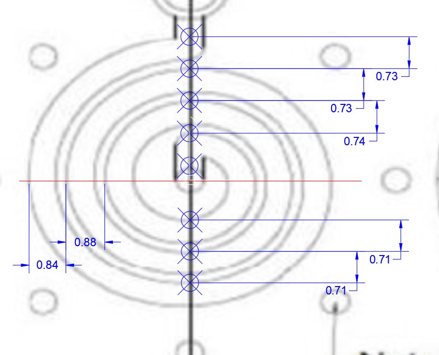

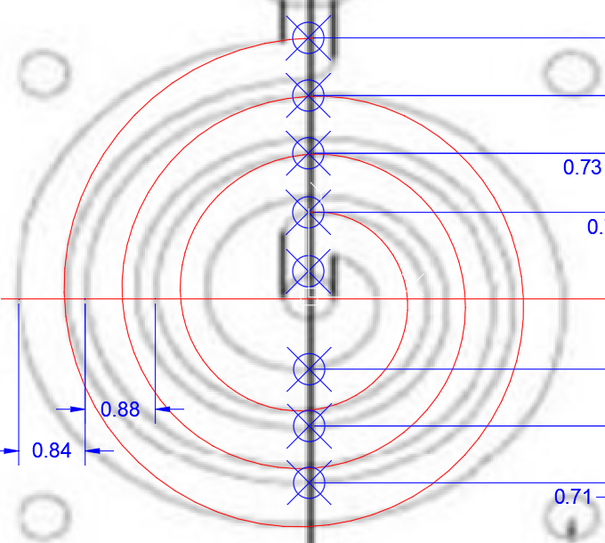

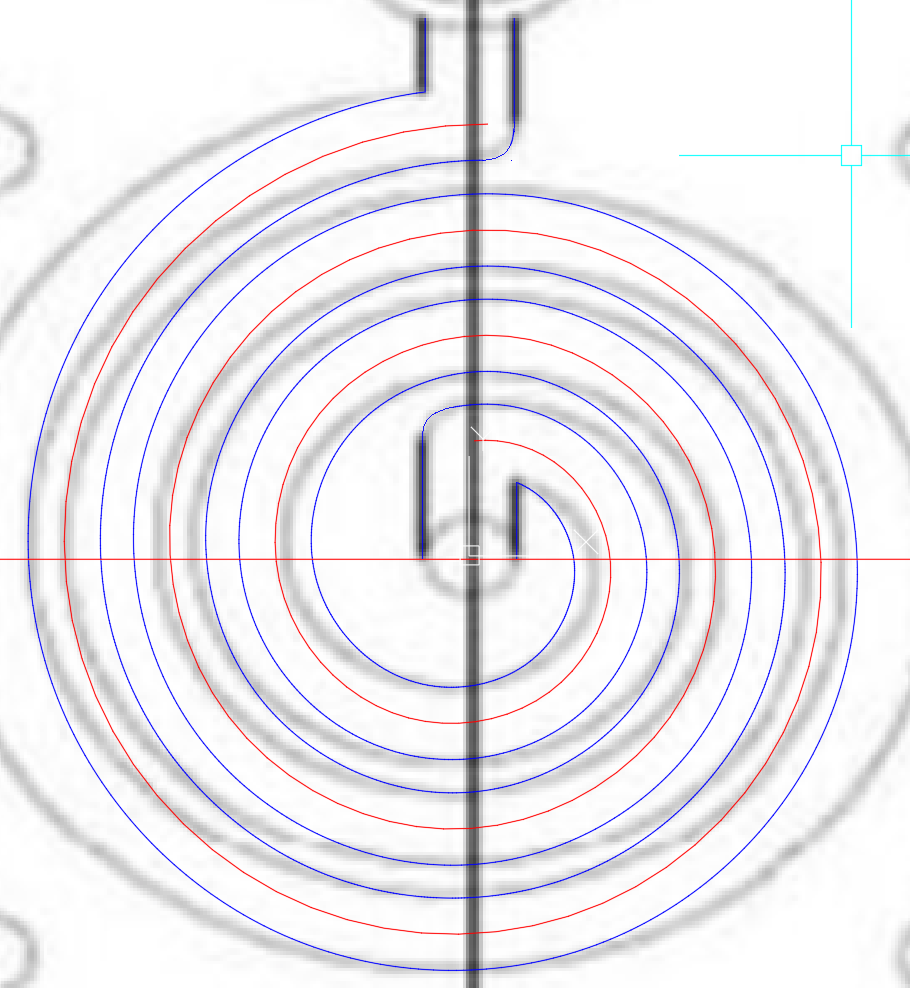

  1. The image of the spiral is distorted as noted below. Position the image so that the center is at 0,0 then lock its layer. CReate points above the center to define where the helix should pass. Make sure the helix center is also at 0,0. Create a CW helix of 3 turns. Drag its grips so that it looks like the red helix below. Make a copy of the red helix (copy 0,0) and change the number of turns of the copy to 4. Then drag its start and end handles as needed. Use splines and or arc to complete the geometry.

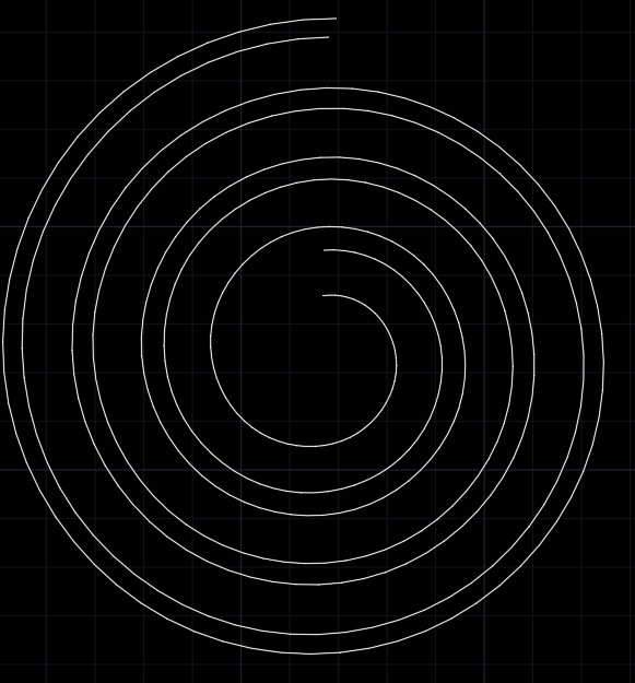

  4. Yes, a spline is created. Rather than creating two helixes, one representing the centerline of the groove could be made and then offset used to create the two sides of the grove.

  6. The helix command should be a big help.
