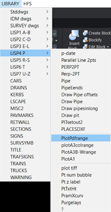

  2. As suggested I use a custom mnu rather than using the CUI as the editor, you just make a menu using notepad. You can make custom toolbars the same way. Behind the menu is a Autoload or a load a lisp. Another

  7. Not familiar with CADTools but have been customizing AutoCAD's interface for over 30 years. Why not just build a custom CUI referencing your lisp functions? I'd recommend loading them as needed with autoload or in the macro when the function is called. Plenty of us could help you with that.
