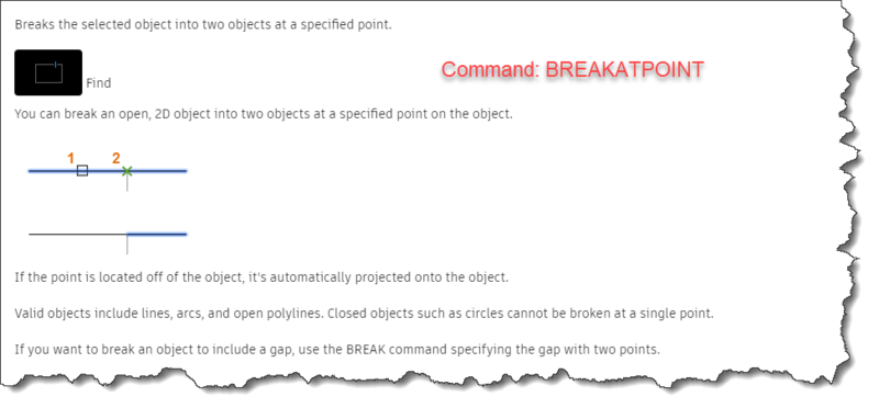

  2. There is a new BREAKATPOINT command that does this. I made an alias of BAP for it
    1 point
