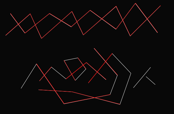

  1. You should post a drawing of what you're working with. If there are no curves in your linework then use INTERS as @mhupp suggested. Here's a quick example. It does not draw a line 'yet' but identifies both straight segments of intersections. Does not see self intersections. (defun c:foo (/ _f _foo a j pts r s z) (defun _f (p) (list (car p) (cadr p))) (defun _foo (o / p r) (setq p (vlax-get o 'coordinates)) (if (= "AcDbPolyline" (vla-get-objectname o)) (while p (setq r (cons (mapcar '+ p '(0 0)) r)) (setq p (cddr p))) (while p (setq r (cons (mapcar '+ p '(0 0 0)) r)) (setq p (cdddr p))) ) (reverse r) ) (if (setq s (ssget '((0 . "*POLYLINE")))) (foreach e (vl-remove-if 'listp (mapcar 'cadr (ssnamex s))) (setq z (_foo (vlax-ename->vla-object e))) (setq pts (cons (mapcar '(lambda (r j) (list r j)) z (cdr z)) pts)) ) ) (while (cadr pts) (setq a (car pts)) (setq pts (cdr pts)) (foreach p a (foreach p2 (apply 'append pts) (and (inters (_f (car p)) (_f (cadr p)) (_f (car p2)) (_f (cadr p2))) (progn (grdraw (car p) (cadr p) 1) (grdraw (car p2) (cadr p2) 1)) ) ) ) ) (princ) )

  2. @mdchuyen Give this a try .. it checks for areas within a given range. (defun c:foo (/ c mn mx s) (cond ((and (or (setq mn (getdist "\nEnter minimum area value to check:<0> ")) (setq mn 0)) (or (setq mx (getdist "\nEnter maximum area value to check:<500> ")) (setq mx 500)) (setq c (acad_truecolordlg 1)) (setq s (ssget '((0 . "LWPOLYLINE")))) ) (foreach e (vl-remove-if 'listp (mapcar 'cadr (ssnamex s))) (if (<= mn (vlax-curve-getarea e) mx) (entmod (append (entget e) c)) (ssdel e s) ) ) (sssetfirst nil s) ) ) (princ) )

  3. Give this a try: (defun c:foo (/ a i ll n s ur) (cond ((and (or (setq n (getdist "\nEnter area value to check:<300> ")) (setq n 300)) ;; (setq c (acad_truecolordlg 1)) (setq s (ssget '((0 . "LWPOLYLINE") (8 . "living")))) (setq i 0) ) (foreach e (vl-remove-if 'listp (mapcar 'cadr (ssnamex s))) (if (>= (setq a (vlax-curve-getarea e)) n) (progn (entmake (append (entget e) '((8 . "LIVING-AREA") (62 . 1)))) (vla-getboundingbox (vlax-ename->vla-object e) 'll 'ur) (setq ll (vlax-safearray->list ll)) (setq ur (vlax-safearray->list ur)) (setq ll (mapcar '/ (mapcar '+ ll ur) '(2 2 2))) (setq i (+ i a)) (entmake (list '(0 . "TEXT") '(100 . "AcDbEntity") '(67 . 0) '(8 . "LIVING-AREA") '(62 . 1) '(100 . "AcDbText") (cons 10 ll) '(40 . 1.5) (cons 1 (vl-princ-to-string a)) '(50 . 0.0) '(41 . 1.0) '(51 . 0.0) '(71 . 0) '(72 . 1) (cons 11 ll) '(100 . "AcDbText") '(73 . 2) ) ) ) ;; (ssdel e s) ) ) ;; Print total to command line (print i) ;; (sssetfirst nil s) ) ) (princ) )
