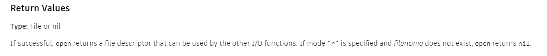

  6. @mhupp that is true, but I think that generates a different error code (or no error code - see test below) than a "bad argument type" on a string value. Command: (open "C:\\nofilehere.csv" "r") nil from (open) function in help:
