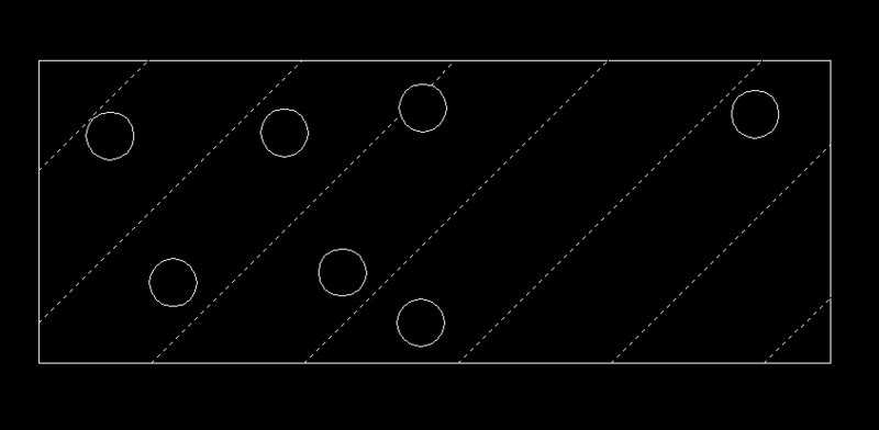

  1. This was answered in another post maybe on another forum. You can have a room say with say columns and get floor area. Anyway the simple answer is if you can make a hatch that reflects the correct shape then you can get the area, so would need to edit Lee's code to pick a hatch rather than a pline.
    2 points
