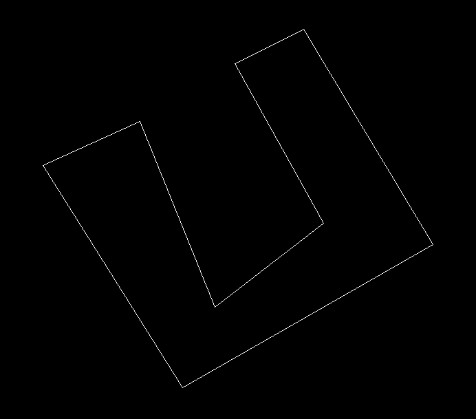

  4. Steven P draw a pline as a "U" rotated and compare the methods suggested. You could average points also but it may not be geom centre.
    1 point
