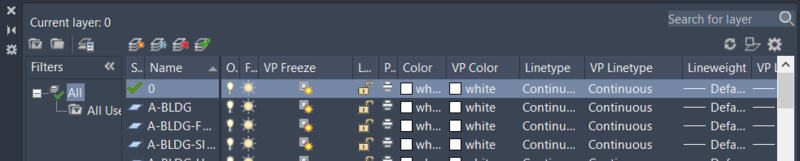

  6. In a viewport you use VPLAYER, viewport layer. Just go to the layer display and scroll across to the right and you will see viewport settings for layers you can freeze a layer Vpfreeze even change its color. So turn on all layers in model and use the freeze option, a manual way is VPLAYER.
