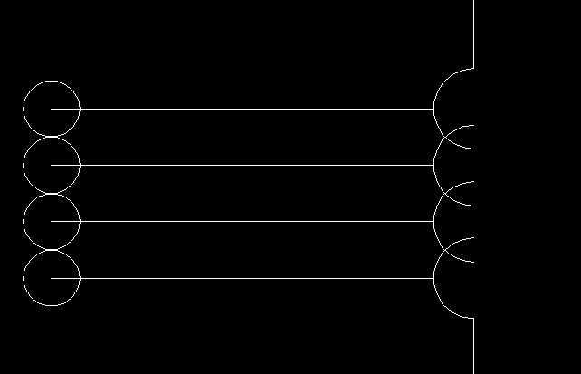

  2. I agree with mhupp. It looks like you're working in perspective or possibly a rotated UCS. In the image below, I projected your trim line and it looks like it's trimming exactly where it's supposed to.
    1 point
  3. @neuri check to see if all the lines are on the same elevation. Also check to see if perspective view is off. (setvar 'perspective 0) ; Turn off Perspective view in current viewport

  7. This uses ldata so the variable is saved to the drawing. If it hasn't been saved yet it will run "SETUP" use this command to change the radius. if the radius has been set it will skip and ask you to select blocks. then line. This command will repeat until canceled by not selecting more blocks. updated entmake to make arcs rather then lines. --edit Seems there was a bit of a bug or I was doing it a stupid way to cause the bug. got rid of the error checking for the line (12 lines of code) and just replaced i with nentselp to select the longer side of the line left when trimmed. Everything should work 100% now. Also if blocks are closer then r vertically this is what will happen. ;;----------------------------------------------------------------------;; ;; CONNECT BLOCK TO LINE (defun C:FOO (/ r ss blklst l1 l2 cir p1 p2 l2 cir p3 p4 p5) (if (setq r (vlax-ldata-get "radius" "R")) (progn) (C:SETUP) ) (while (setq ss (ssget '((0 . "INSERT")))) (setq blklst (mapcar '(lambda (x) (list (cdr (assoc 10 (entget x))) x)) (vl-remove-if 'listp (mapcar 'cadr (ssnamex SS))))) (setq blklst ;sorts blocks right to left bottom to top from insertion pointy (mapcar 'cadr (vl-sort blklst '(lambda (a b) (if (equal (cadr (car a)) (cadr (car b)) 1e-6) (< (car (car a)) (car (car b))) (< (cadr (car a)) (cadr (car b))) ) ) ) ) ) (setq l1 (car (entsel "\nSelect Line: "))) y (foreach ent Blklst (setq p1 (vlax-get (vlax-ename->vla-object ent) 'InsertionPoint)) (setq p2 (vlax-curve-getclosestpointto (vlax-ename->vla-object l1) p1)) (entmake (list (cons 0 "LINE") (cons 10 p1) (cons 11 p2))) (setq l2 (entlast)) (entmake (list (cons 0 "CIRCLE") (cons 10 p2) (cons 40 r))) ;delete first line and change r to hard code radius (setq cir (entlast)) (setvar 'cmdecho 0) (command "TRIM" cir "") (command (list l1 p2)) (command (list l2 p2)) (command "") (setvar 'cmdecho 1) (entdel cir) (setq p3 (polar p2 (+ (angle p1 p2) (/ pi 2)) r)) (setq p4 (polar p2 (- (angle p1 p2) (/ pi 2)) r)) (cond ((and (equal (car p1) (car p2) 0.001) (> (cadr p1) (cadr p2))) (setq l1 (car (nentselp p3))) ) ((and (equal (car p1) (car p2) 0.001) (< (cadr p1) (cadr p2))) (setq l1 (car (nentselp p4))) ) ((< (car p1) (car p2)) (setq l1 (car (nentselp p3))) ) ((> (car p1) (car p2)) (setq l1 (car (nentselp p4))) ) ) (entmake (list (cons 0 "ARC") (cons 10 p2) (cons 40 r) (cons 50 (angle p2 p3)) (cons 51 (angle p2 p4)))) ) ) (princ) ) ;;----------------------------------------------------------------------;; ;; SETS R FOR FOO COMMAND (defun C:SETUP () (or (setq *r (vlax-ldata-get "Radius" "R")) (setq *r 0.500)) (if (setq r (getdist (strcat "\nSet Radius [" (rtos *r 2) "]: "))) (vlax-ldata-put "Radius" "R" r) (vlax-ldata-put "Radius" "R" (setq r *r)) ) )
