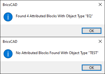

  6. Simple enough Added a counter. If you don't like/want the found message just delete the 2nd alert line in the last if statement. ;;;;;;;;;;;;;;;;;;;;;;;;;;;;;;;;;;;;;;;;;;;;;;;;;;;;;;;;;;;; ;; Original by LeeMac @ cadtutor.net 16 NOV 2010 ;; So long ago the saved link is broken. ;;;;;;;;;;;;;;;;;;;;;;;;;;;;;;;;;;;;;;;;;;;;;;;;;;;;;;;;;;;; ;; Mod by SteveJ July 2022 to highlight all of specified OBJ TYPE. (defun c:OBJ (/ i ot ss attLst Box ul lr) (vl-load-com) (setq i 0) ;added line (setq ot (strcase (getstring "Enter OBJ TYPE to locate: "))) (if (setq ss (ssget "_X" '((0 . "INSERT") (66 . 1)))) (progn (command "regen") ;erases current highlighting for next search. (foreach Obj (mapcar 'vlax-ename->vla-object (mapcar 'cadr (ssnamex ss))) (setq attLst nil) (foreach att (vlax-safearray->list (vlax-variant-value (vla-getAttributes Obj))) (setq attLst (cons (cons (vla-get-TagString att) (vla-get-TextString att)) attLst)) ) (if (and (assoc "OBJTYPE" attLst) (eq ot (cdr (assoc "OBJTYPE" attLst))) (setq Box (assoc "BOXSIZE" attLst) Box (read (cdr Box)) ) ) (progn (setq ul (list (car Box) (cadr Box)) lr (list (caddr Box) (cadddr Box)) ) (grvecs (list 1 lr (list (car lr) (cadr ul)) ;RIGHT 1 ul (list (car lr) (cadr ul)) ;TOP 1 lr (list (car ul) (cadr lr)) ;BOTTOM 1 ul (list (car ul) (cadr lr)) ;LEFT ) ) (setq i (1+ i)) ;added line ) ) ) ) (princ "\n<!> No Attributed Blocks Found <!>") ) (if (eq i 0) ;added if statement (alert (strcat "No Attributed Blocks Found With Object Type \"" ot "\"")) (alert (strcat "Found " (itoa i) " Attributed Blocks With Object Type \"" ot "\"")) ) (princ) )
    1 point
