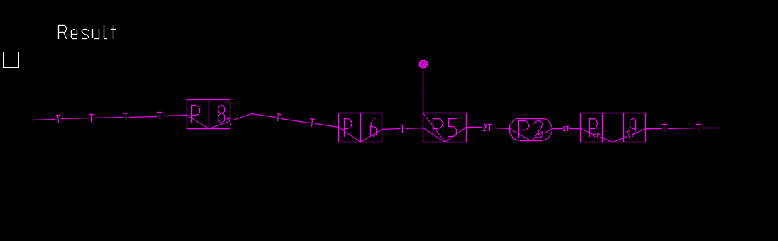

  1. ; CONNECT - 2022.05.27 exceed ; https://www.cadtutor.net/forum/topic/75205-lisp-to-connect-polylines-to-centre-or-centroid-of-blocks/ ; ; Connect the polyline connected to the border of the block by extending it to the center point of the block. ; ; Command List ; CONNECT - Connect to Insertion Point ; CONNECT2 - Connect to Center Point ; ; To avoid errors, only fix if the polyline's first point or endpoint is inside the block. = It does not modify when passing or passing through a block. (vl-load-com) (defun c:CONNECT ( / basept ) (setq basept "InsertionPoint") (ex:CONNECT basept) ) (defun c:CONNECT2 ( / basept ) (setq basept "CenterPoint") (ex:CONNECT basept) ) (defun ex:CONNECT ( basept / ssb ssbl ssbindex 1blk 1blkobj pt1 pt2 midpt ssp sspl sspindex 1pl 1plobj 1plcoord 1plstartpt 1plcoordlen 1plendpt newcoord1 newcoord2 ) (setq ssb (ssget ":L" '((0 . "INSERT")))) (setq ssbl (sslength ssb)) (setq ssbindex 0) (repeat ssbl (setq 1blk (ssname ssb ssbindex)) (setq 1blkobj (vlax-ename->vla-object 1blk)) (vla-getboundingbox 1blkobj 'MinPt 'MaxPt) (setq pt1 (vlax-safearray->list MinPt)) (setq pt1 (list (car pt1) (cadr pt1))) (setq pt2 (vlax-safearray->list MaxPt)) (setq pt2 (list (car pt2) (cadr pt2))) (cond ((= basept "InsertionPoint") (setq midpt (vlax-safearray->list (vlax-variant-value (vlax-get-property 1blkobj 'InsertionPoint)))) ) ((= basept "CenterPoint") (setq midpt (list (/ (+ (car pt1) (car pt2)) 2) (/ (+ (cadr pt1) (cadr pt2)) 2) )) ) ) ;(princ midpt) (setq ssp (ssget "C" pt1 pt2 '((0 . "LWPOLYLINE")))) (setq sspl (sslength ssp)) (setq sspindex 0) (repeat sspl (setq 1pl (ssname ssp sspindex)) (setq 1plobj (vlax-ename->vla-object 1pl)) (setq 1plcoord (vlax-safearray->list (vlax-variant-value (vlax-get-property 1plobj 'Coordinates)))) ;(princ 1plcoord) (setq 1plstartpt (list (car 1plcoord) (cadr 1plcoord))) (setq 1plcoordlen (length 1plcoord)) (setq 1plendpt (list (nth (- 1plcoordlen 2) 1plcoord) (last 1plcoord))) (setq newcoord1 '()) ; case for startpoint (cond ((and (and (>= (car 1plstartpt) (car pt1)) (<= (car 1plstartpt) (car pt2))) (and (>= (cadr 1plstartpt) (cadr pt1)) (<= (cadr 1plstartpt) (cadr pt2)))) ;(princ "\n 1pl startpt - ") ;(princ 1plstartpt) (setq newcoord1 (cons (cadr midpt) 1plcoord)) (setq newcoord1 (cons (car midpt) newcoord1)) (vlax-put 1plobj 'coordinates newcoord1) (setq 1plcoord newcoord1) ) ) (setq newcoord2 '()) ; case for endpoint (cond ((and (and (>= (car 1plendpt) (car pt1)) (<= (car 1plendpt) (car pt2))) (and (>= (cadr 1plendpt) (cadr pt1)) (<= (cadr 1plendpt) (cadr pt2)))) ;(princ " / 1pl endpt - ") ;(princ 1plendpt) (setq 1plcoord (reverse 1plcoord)) (setq newcoord2 (cons (car midpt) 1plcoord)) (setq newcoord2 (cons (cadr midpt) newcoord2)) (setq newcoord2 (reverse newcoord2)) (vlax-put 1plobj 'coordinates newcoord2) ) ) (setq sspindex (+ sspindex 1)) ) (setq ssbindex (+ ssbindex 1)) ) (princ) ) you can use both option now

  2. ; CONNECT - 2022.05.27 exceed ; https://www.cadtutor.net/forum/topic/75205-lisp-to-connect-polylines-to-centre-or-centroid-of-blocks/ ; ; Connect the polyline connected to the border of the block by extending it to the center point of the block. ; ; Command : CONNECT ; ; To avoid errors, only fix if the polyline's first point or endpoint is inside the block. ; = It does not modify when passing or passing through a block. (vl-load-com) (defun c:CONNECT ( / ssb ssbl ssbindex 1blk 1blkobj pt1 pt2 midpt ssp sspl sspindex 1pl 1plobj 1plcoord 1plstartpt 1plcoordlen 1plendpt newcoord1 newcoord2 ) (setq ssb (ssget ":L" '((0 . "INSERT")))) (setq ssbl (sslength ssb)) (setq ssbindex 0) (repeat ssbl (setq 1blk (ssname ssb ssbindex)) (setq 1blkobj (vlax-ename->vla-object 1blk)) (vla-getboundingbox 1blkobj 'MinPt 'MaxPt) (setq pt1 (vlax-safearray->list MinPt)) (setq pt1 (list (car pt1) (cadr pt1))) (setq pt2 (vlax-safearray->list MaxPt)) (setq pt2 (list (car pt2) (cadr pt2))) (setq midpt (list (/ (+ (car pt1) (car pt2)) 2) (/ (+ (cadr pt1) (cadr pt2)) 2) )) ;(princ midpt) (setq ssp (ssget "C" pt1 pt2 '((0 . "LWPOLYLINE")))) (setq sspl (sslength ssp)) (setq sspindex 0) (repeat sspl (setq 1pl (ssname ssp sspindex)) (setq 1plobj (vlax-ename->vla-object 1pl)) (setq 1plcoord (vlax-safearray->list (vlax-variant-value (vlax-get-property 1plobj 'Coordinates)))) ;(princ 1plcoord) (setq 1plstartpt (list (car 1plcoord) (cadr 1plcoord))) (setq 1plcoordlen (length 1plcoord)) (setq 1plendpt (list (nth (- 1plcoordlen 2) 1plcoord) (last 1plcoord))) (setq newcoord1 '()) ; case for startpoint (cond ((and (and (>= (car 1plstartpt) (car pt1)) (<= (car 1plstartpt) (car pt2))) (and (>= (cadr 1plstartpt) (cadr pt1)) (<= (cadr 1plstartpt) (cadr pt2)))) ;(princ "\n 1pl startpt - ") ;(princ 1plstartpt) (setq newcoord1 (cons (cadr midpt) 1plcoord)) (setq newcoord1 (cons (car midpt) newcoord1)) (vlax-put 1plobj 'coordinates newcoord1) (setq 1plcoord newcoord1) ) ) (setq newcoord2 '()) ; case for endpoint (cond ((and (and (>= (car 1plendpt) (car pt1)) (<= (car 1plendpt) (car pt2))) (and (>= (cadr 1plendpt) (cadr pt1)) (<= (cadr 1plendpt) (cadr pt2)))) ;(princ " / 1pl endpt - ") ;(princ 1plendpt) (setq 1plcoord (reverse 1plcoord)) (setq newcoord2 (cons (car midpt) 1plcoord)) (setq newcoord2 (cons (cadr midpt) newcoord2)) (setq newcoord2 (reverse newcoord2)) (vlax-put 1plobj 'coordinates newcoord2) ) ) (setq sspindex (+ sspindex 1)) ) (setq ssbindex (+ ssbindex 1)) ) (princ) )

  3. Explain more need dwg or images at least.

  4. Brilliant mate! Love your work. This works perfectly
    1 point
  5. Hi exceed, This is brilliant! Is there a small adjustment if I want the vertex to snap to the insertion point instead of the Block centre? I will give a try and get back to you! You are amazing mate Don't worry about it if it is too much hassle im still happy and very grateful for this!
