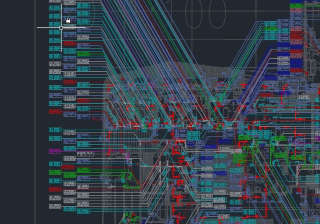

  16. my drawing is like to this drawing , many cbw need to show, how can i align angle and heignt all leader easily
