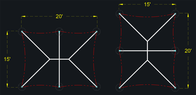

  1. Thanks everyone. After changing the Cons 090 code from 4 to 6, everything worked correctly. I just had to then get the sequence right for the horizontal and the vertical layouts the user might draw. Horizontal sequence: (entmake (list '(000 . "LWPOLYLINE") '(100 . "AcDbEntity") '(100 . "AcDbPolyline") '(090 . 6) '(070 . 1) (cons 010 (trans p 1 z)); Pt1 (cons 042 (car b)) (cons 010 pt5); Pt5: Midpoint on one side (cons 042 (car b)) (cons 010 (trans (list (car q) (cadr p)) 1 z)); Pt4 (cons 042 (cadr b)) (cons 010 (trans q 1 z));Pt3 (cons 042 (car b)) (cons 010 pt6);Pt6: Midpoint on the other side (cons 042 (car b)) (cons 010 (trans (list (car p) (cadr q)) 1 z));Pt2 (cons 042 (cadr b)) (cons 210 z) (cons 48 scaledLtype);linetype scaling ) Vertical Sequence: (entmake (list '(000 . "LWPOLYLINE") '(100 . "AcDbEntity") '(100 . "AcDbPolyline") '(090 . 6) '(070 . 1) (cons 010 (trans p 1 z)); Pt1 (cons 042 (car b)) (cons 010 (trans (list (car q) (cadr p)) 1 z)); Pt4 (cons 042 (cadr b)) (cons 010 pt6); Pt6: Midpoint on one side (cons 042 (car b)) (cons 010 (trans q 1 z));Pt3 (cons 042 (car b)) (cons 010 (trans (list (car p) (cadr q)) 1 z));Pt2 (cons 042 (cadr b)) (cons 010 pt5);Pt5: Midpoint on the other side (cons 042 (car b)) (cons 210 z) (cons 48 scaledLtype);linetype scaling ) I added it to my original code and it all works great now. Here is a sample image of the end results after the code update: User draws a 20' x 15' rectangle horizontally and then vertically: Thanks to everyone for your input!
