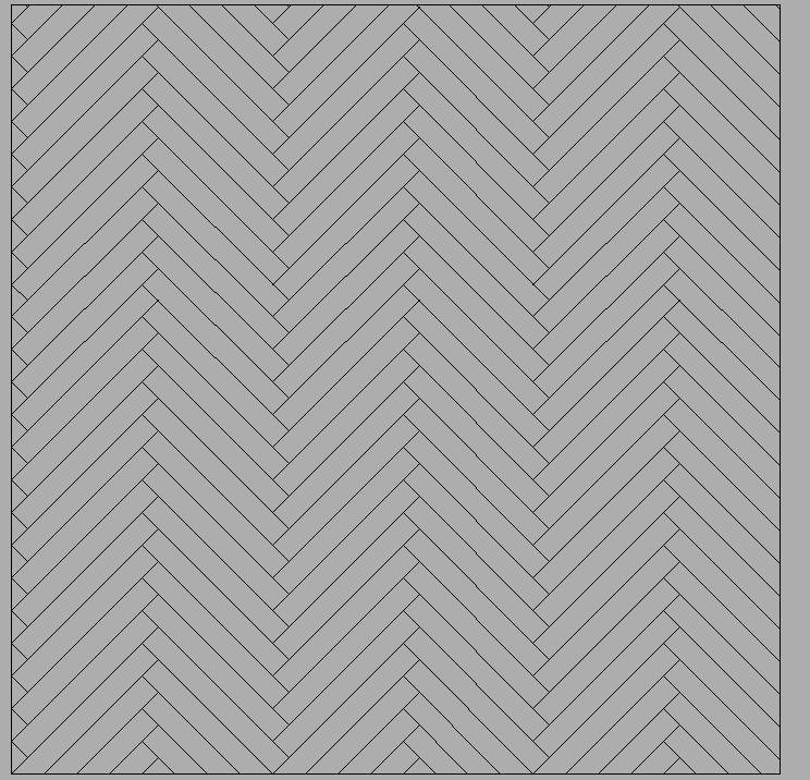

  1. I saw on another forum a request for a 3" x 24" herringbone hatch. I thought I would post one, (keeps the brain going!!) *Herringbone3x24 45,0,0,3,3,27,-21 135,2.121320344,2.121320344,3,-3,27,-21 *eldon may 2022 Herringbone3x24.pat
