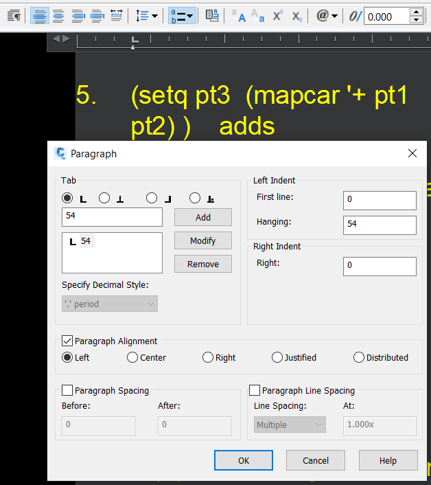

  6. AutoCAD Help → AutoCAD User's Guide → Create Notes, Labels, and Leaders → Add Notes as Single-Line and Multiline Text → About Multiline Text Format https://help.autodesk.com/view/ACD/2023/ENU/?guid=GUID-E4DC3A14-3F0A-46AE-9503-6BBEE8DAF916 → Tabs and Indents Works even easier than Word to me. Just select the portion of mtext you want to apply paragraph formatting to first. Needed for many notes in our drawings.

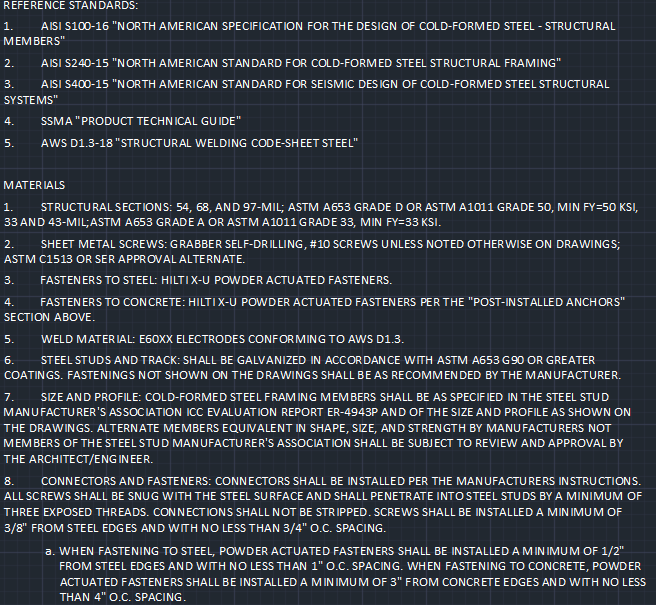

  7. I avoided trying to learn how to do paragraph indenting in mtext its just not clear how to do once we had our std notes set up did not need to do again as could add and subtract but we did not do 1 a b c etc I think its in here pick the pi symbol change the first line maybe after highliting"a paragraph" I got something close by setting first line to 20 and hanging to 40. But really no idea what I was doing for consistency.

  8. BIGAL, That's definitely one way of doing it. Trouble is to make this usable by all I need to keep it inside of AutoCAD. What I find is that if I add a tab on that line it changes "A" to "A.A". I believe there is a way to do this, I'll just have to hack around with it some more.

  9. I cheated copied and pasted to word added the a sub item then made a new Mtext and copy pasted from Word. Should have spent some more time formatting paragraphs.
