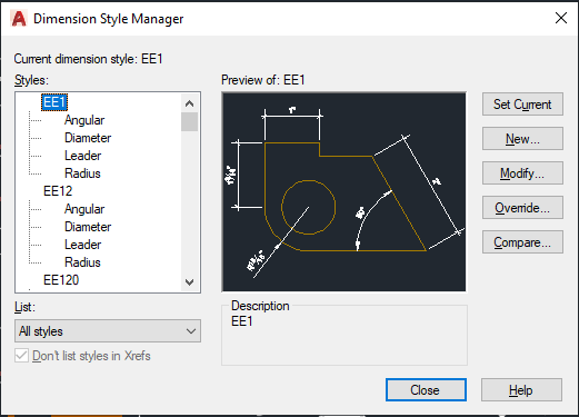

  3. We have over 45 different clients and sometime use there DIMSTYLES. We have HVAC, Structural, Electrical I we use. Each Client we have created DWT drawing with DIMSTYLES! I suggested that we use the Tool Palette with each client DIMSTYLES. Would like to have a dialog box to select which DIMSTYLE scale I want to us. I want to utilize Tool Palette for other Standard drawing stuff. Plus I was looking to a “FREE” block manager to put HVAC, Mech, Structural blocks that allow to insert blocks in set layer, scale!

  8. Would like to have a dialog box to select which DIMSTYLE scale I want to us. Have a look at my multi radio buttons.lspMulti radio buttons.lsp
    1 point
  9. Old fashioned and its free a custom MNU. Can set layers & scales etc as you insert. Tool Palette now and its free.
    1 point
  10. Set up template drawing with all the correct plot styles and dim styles save it out with clients name. then use the following on new drawings to pull from said template. http://www.lee-mac.com/steal.html
