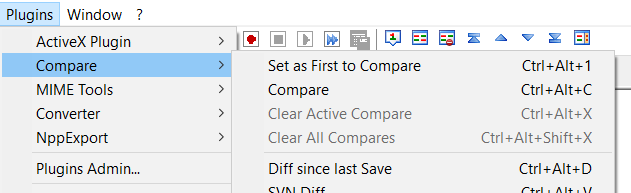

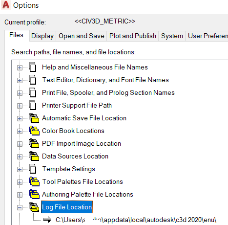

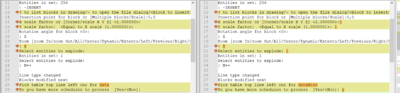

  1. Hi devitg Logfileon setvar ? * may need press enter to get all pages of setvar Logfileooff You now have a logfile.log its saved here. I have mine set to a TEMP directory easier to get at. Ok change 1 variable only. Do all the steps above again, you now have 2 Log files and can compare. In Notepad++ is a compare option makes it much easier. If you dont have Notepad++ open 2 Notepad files and scroll. I think I had to add it to Notepad++ it was in plugin options.
