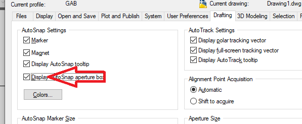

  1. Hi all , it was this. Display Auto snap aperture box , shall be unmarked. Problem solved Thanks

  3. That system variable can also be found in OPTIONS on the DISPLAY tab
    1 point
  4. Yes! Or just enter ROLLOVERTIPS at the command line and enter 0 and the cursor will never stick to anything again.

  7. You appear to be on the page to which Tombu is referring, as per the screenshot. Go to the top of the list on the right side, and DESELECT (turn off) GENERAL, just like in the screenshot.

  9. Did you watch the video? English is my only language, I couldn't read anything in the image you attached. You could deselect the box for General shown in the video but you really need to first pick Hatch from the list of object types and unselect the box for General on the right. Then the curser will no longer stop on hatches trying to display information about them. There is also a ROLLOVERTIPS (System Variable) you can set to 0 so you'll never see another one again! https://knowledge.autodesk.com/support/autocad/learn-explore/caas/CloudHelp/cloudhelp/2020/ENU/AutoCAD-Core/files/GUID-22E75D39-E601-41BD-935C-B359345DC47E-htm.html That's what mine is set to!
    1 point
  10. Open the CUI and select Rollover Tooltips, then select Hatch on the right and unselect the box for General on the right. On the bottom-right click the [Apply] button then the [OK] button. Your cursor will no longer stick to Hatches! Many of my drawings are dense with contour lines represented as lwpolylines so I keep Polylines unselected as a Rollover Tooltip in mine. Customizing Rollover Tooltips https://help.autodesk.com/view/ACD/2022/ENU/?caas=caas/video/youtube/lesson/144642-courseId-100329.html
