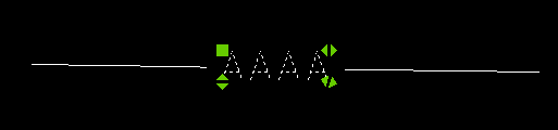

  1. Would not Mtext with a background mask be easier if you change text it hides line, oh yeah second bit click line its still true length not 2 parts with a gap. You can adjust side margin also. I seem to remember make mtext then edit entlast to get the mask.
