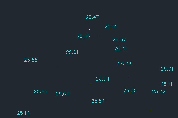

  4. Sorry, Updated ....... (defun c:bi (/ ss ent itm val pnt ) (vl-load-com) (setvar "OSMODE" 0) (setvar "CMDECHO" 0) (command "-LAYER" "S" "CAO DO" "") (setq ss (ssget (list (cons 0 "TEXT,INSERT") (cons 8 "CAO DO")))) (repeat (setq x (sslength ss)) (setq ent (ssname ss (setq x (- x 1)))) (setq itm (cdr (assoc 0 (entget ent)))) (if (eq itm "TEXT") (progn (setq ins (cdr (assoc 11 (entget ent)))) (setq val (cdr (assoc 1 (entget ent)))) (setq pnt (list (car ins) (cadr ins) (atof val))) (command "-INSERT" "donut" pnt 0.0002 0.0002 0) (entmod (subst (list 10 (car ins) (cadr ins) (atof val)) (assoc 10 (entget ent)) (entget ent))) ) ) (if (eq itm "INSERT") (entdel ent)) ) (princ) ) Block insert.lsp

  6. Try This (defun c:bi () (vl-load-com) (setvar "OSMODE" 0) (command "-LAYER" "S" "CAO DO" "") (setq ss (ssget (list (cons 0 "TEXT,INSERT") (cons 8 "CAO DO")))) (repeat (setq x (sslength ss)) (setq ent (ssname ss (setq x (- x 1)))) (setq itm (cdr (assoc 0 (entget ent)))) (if (eq itm "TEXT") (progn (setq ins (cdr (assoc 11 (entget ent)))) (setq val (cdr (assoc 1 (entget ent)))) (setq pnt (list (car ins) (cadr ins) (atof val))) (command "-INSERT" "donut" pnt 0.0002 0.0002 0) ) ) (if (eq itm "INSERT") (entdel ent)) ) (princ) ) Block insert.lsp

  7. if you copy from "(vl-load-com)" well. i don't know why. It works in my test. I load only that lisp, except others for test
