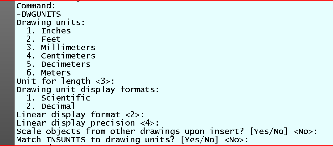

  2. Glad to hear that BIGAL and eldon have gotten you back on the tracks. You should explore the -DWGUNITS command, which is quite informative and helpful in such situations. I suggest increasing the commandline history window to about 6 lines, to give you some overview of the conditions in your drawing. I would open a COPY of a file, and play around with it, until you feel you understand the functionality included. READ the commandline prompts very carefully, don't rush, so that you better understand and remember. The numbers displayed <THUSLY> indicate the current settings in your open drawing. For instance Unit for length <3> means that the drawing units are currently set to Millimeters.

  3. I am not quite sure that you are understanding how AutoCAD works with dimensions. Just because you start with a metric template does not automatically make Imperial dimensions become metric dimensions. AutoCAD works in drawing units, which you are free to choose what those units are. So the drawing with your import will probably be showing 6 drawing units instead of 6 inches. If you have a dimension of 6 inches in the drawing, you have to import it scaled so that the 6 inch dimension actually shows 152.4 drawing units. So take BIGAL's advice and scale by 25.4.
