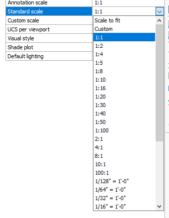

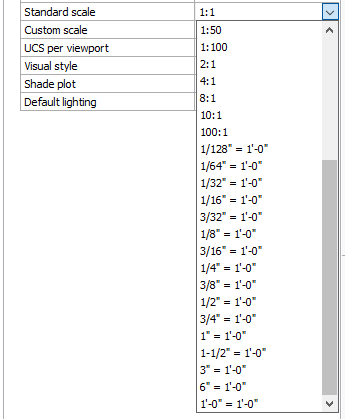

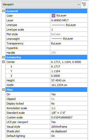

  6. I don't know. Tried changing the scale to see if that would do anything and something weird happened. this is the list off all my standard scales I have in BricsCAD. If you count down to from "custom" to 1/8"=1'-0" its 24th in the list. and StandardScale = 24. So i was like "huh that's weird". When I changed the viewport to 1:1 the StandardScale = 2. also 2nd in the list. Changed to 100:1 StandardScale = 13 and you guessed it 13th in the list. Doesn't seem to be anything wrong with the view port. its just how (vla-get-Standardscale (vlax-ename->vla-object v)) displays as.
    1 point
