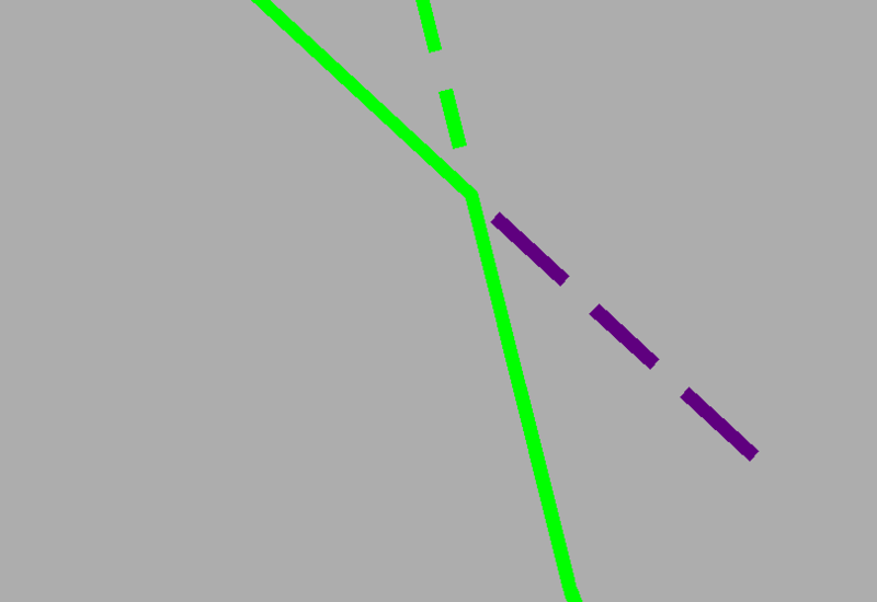

  3. I got a way to do it. First of all set up a UCS based on the green polyline. Then make a block of the green line in that UCS. Then change back to World UCS and insert the block. Place it and make sure the elevation is 0. Now Fillet works.

  6. non-coplanar means that the line/plines have different Z values and so a fillet would be on a odd plane as an answer, try Flatten on the 2 objects, then fillet. If that does not work you may need convert 3dpoly to 2dpoly just google for the lisp.
