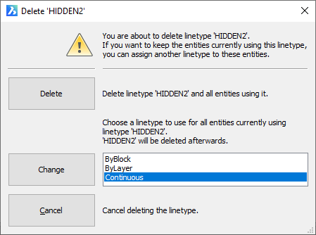

  4. don't know how to do it with lisp but you can just delete it from the linetype manager. it should give you a warning saying if you delete this line type it will delete all entity's assigned it. or you can re assign a new line type to those entity's. or that's what it does in BricsCAD.

  7. Sorry, maybe I was not clear. I don't want to delete HIDDEN2, I want to replace with it all other linetypes (except Continuous), or merge them (like when merge layers)

  8. That is a free solution type "linetype" to bring up the linetype manager in autocad should look like this. Select hidden 2 and delete in the top right.
