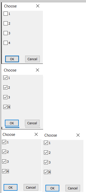

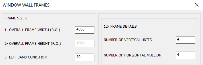

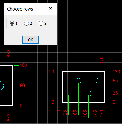

  1. Thanks Mhupp, for me given various styles of holes would have to start again, I have used the library dcl routines as they are dynamic in terms of number of holes. I would do something like this. So if 4 holes required and 1 row you can turn on of off do a hole, the dcl will show how many holes you ask for. The double row again a double toggle turn on or off holes. A tick means yes a off means no circle. It would be a custom program I have not added the other dcl which is all the dimension values. It would require a custom dcl have done this sort of thing for another client where the entry's match say number of holes. The above depends on the prior number in this case its 4.
