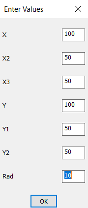

  6. Here is a close start for you. You may want to set a dimension style eg (command "-dimstyle" "R" "standard") tested on your dwg needed dimscale to be reset. ; simple draw a box and dimension it ; By Alan H March 2019 ' info@alanh.com.au (defun ah:box ( / pt1 pt2 pt3 ahl ahh ahoff ) (setq oldsnap (getvar 'osmode)) (setq oldang (getvar 'angdir)) (setq pt1 (getpoint "\nPick lower left")) (setvar 'osmode 0) (if (not AH:getvalsm)(load "Multi Getvals.lsp")) (setq ans (AH:getvalsm (list "Simple rectang" "Enter length" 8 7 "1" "Enter height " 8 7 "2"))) (setq ahL (atof (nth 0 ans))) (setq ahH (atof (nth 1 ans))) (setq pt2 (polar pt1 0.0 ahl)) (setq pt3 (polar pt2 (/ pi 2.0) ahH)) (command "rectang" pt1 pt3) (setq ahoff (* 2.0 (* (getvar 'dimasz)(getvar 'dimscale)))) ; change offset as required (setq pt4 (polar pt2 (* pi 1.5) ahoff)) (command "dim" "hor" pt1 pt2 pt4 "" "exit") (setq pt4 (polar pt3 0.0 ahoff)) (command "dim" "Ver" pt2 pt3 pt4 "" "exit") (setvar 'osmode oldsnap) ) (ah:box) You can see how the box is made so using polar can work out inside box. The multi getvals.lsp needs to be loaded 1st or put in a support path location. Hint for your version. (setq ans (AH:getvalsm (list "Enter Values" "X" 5 4 "100" "X2" 5 4 "50" "X3" 5 4 "50" "Y " 5 4 "100" "Y1 " 5 4 "50" "Y2 " 5 4 "50" "Rad" 5 4 "10" ))) I have added multi toggles for the circles say 1 2 3 4 tick on for position. yes could hard code a single dcl. Multi toggles.lsp Is the inner rectang required or is that just to show the hole positions ? Multi GETVALS.lsp

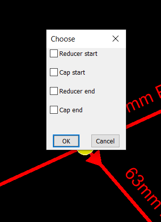

  7. This require say 5 steps to get the answer, for me I would go back steps making life easier, and have layers 63PE, 90PE, and so on removes 1 step of finding a label. If you had a simple lisp draw pline on correct layer and label at same time would make sense. I have something similar to do with pipes and it just means type 90PE at command line. Taking it the next step would be add reducer or end cap, as you draw it, would make a table or csv at the same time want length also ? Ps have table to excel. Now getting into donation could write direct to excel as you draw. So have a think about an overall improvement rather than after the event. This image is from a free library dcl toggle choice. Took like 1 minute to make the calling code.
