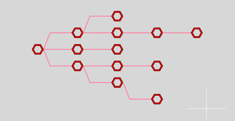

  9. I am trying make a scheme with parent and child Do you have a better solution?
    1 point
