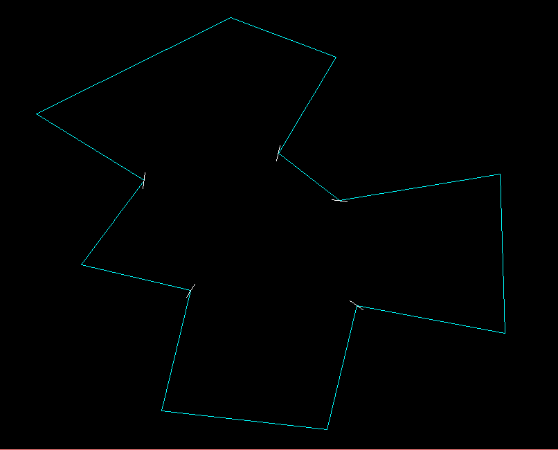

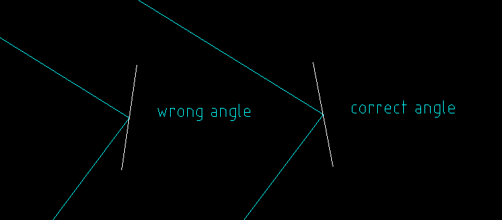

  9. Try this, you should not check for 90 as this is for concrete slabs a architect may have a slab with a angle. Also the bar angle should be a true 90 from the internal corner angle. See images. (defun C:ABAR (/ ) (command "._undo" "_begin") (setq sv_lst (list 'osmode 'cmdecho) sv_vals (mapcar 'getvar sv_lst) blk "rebar" ) (command "-layer" "m" "tempAB" "Color" "cyan" "" "Plot" "Plot" "" "Ltype" "continuous" "" "") (if (setq ss (ssget "_:L" '((0 . "*POLYLINE") ) )) (repeat (setq n (sslength ss)); repeat each edge (command "_.COPY" (ssname ss (setq n (1- n))) "" "0,0" "0,0") (command "_.chprop" "L" "" "LA" "tempAB" "") (command "_.explode" "L") (setq firstRun 0) ;;-+-----repeat each line of the edge ;;;line segment iteration------------------------------------------------------------------------------------ (repeat (setq m (sslength (setq sss (ssget "_P")))) (setq ent (ssname sss (setq m (1- m))) ppt1 (vlax-curve-getStartPoint ent) ppt2 (vlax-curve-getEndPoint ent) );end_setq (if (= firstRun 0) (progn (setq firstRun 1) (setq ent2 (ssname sss (- m 1))) (setq ppt3 (vlax-curve-getEndPoint ent2)) (Insert90 ppt1 ppt2 ppt3) ) (progn (setq ent2 (ssname sss (+ m 1))) (setq ppt3 (vlax-curve-getEndPoint ent2)) (Insert90 ppt1 ppt2 ppt3) ) ) ;; dont erase, for testing. ;;(command "erase" ent "") ) ); repeat each edge ; repeat each line in exploded selection set-------------------------------------------------------------------------------- ); if (command "-purge" "la" "tempAB" "n") (command "._undo" "_end") (princ) ); defun ;; Convert Radians to Degrees (defun rtod (r) (* 180.0 (/ r pi))) ;;figure out where the pt lies (defun lm:getinsideangle (p1 p2 p3) ((lambda (a) (min a (- (+ pi pi) a))) (rem (+ pi pi (- (angle p2 p1) (angle p2 p3))) (+ pi pi)) ) ) ;;D. C. Broad, Jr. ;;(sideof <ray-origin> <another-point-on-ray> <point-to-be-tested>) (defun sideof (p1 p2 p / r) (setq r (cond ((equal p1 p 1e-10) 0) (t (sin (- (angle p1 p) (angle p1 p2)))) ) ) (if (equal r 0 1e-10) 0 r) ) (defun Insert90 (pt1 pt2 pt3) (setq BlkName "rebar") ;;return values ;;negative = point is to the right side of the ray ;;0 = point is on the ray ;;otherwise point is on the left side of the ray. ;;P1 should not equal P2 for meaningful results. (setq p1 pt1) (setq p2 pt2) (setq p3 pt3) (setq lr (sideof pt1 pt2 pt3)) (princ lr) (princ "\n") (if (> lr 0.0) (command "-insert" BlkName "_non" pt2 1 "" (rtod (angle pt2 pt1))) ) (princ) ) (c:abar) Version 2 having a think working out your code.
